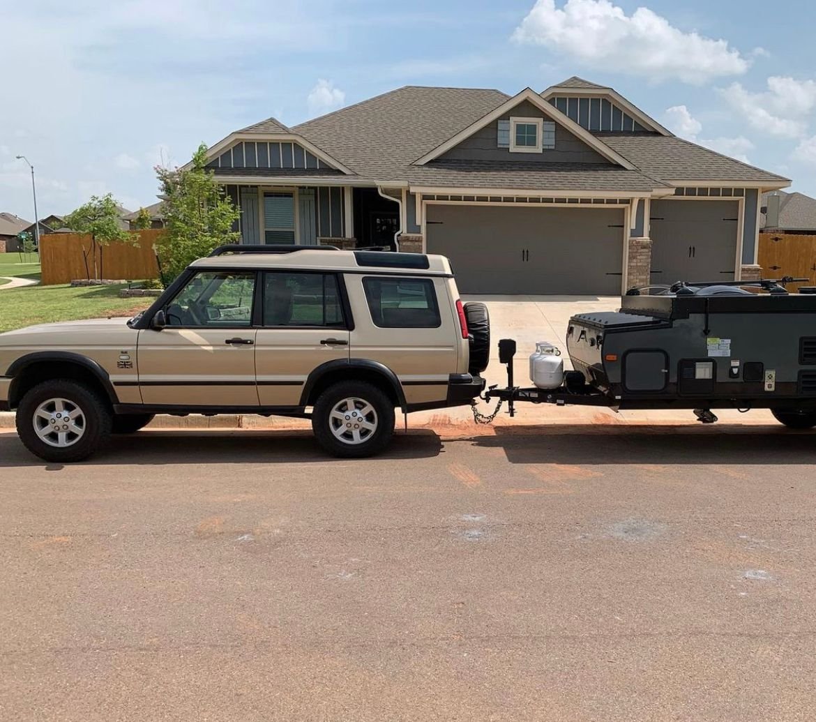

I’ve included a picture of the medium duty springs with a trailer attached. About 250lbs of tongue weight. This is too much squat for my liking. I want to eliminate this as much as possible.

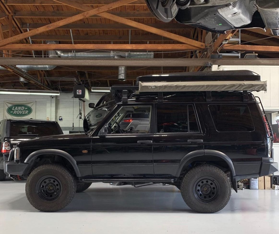

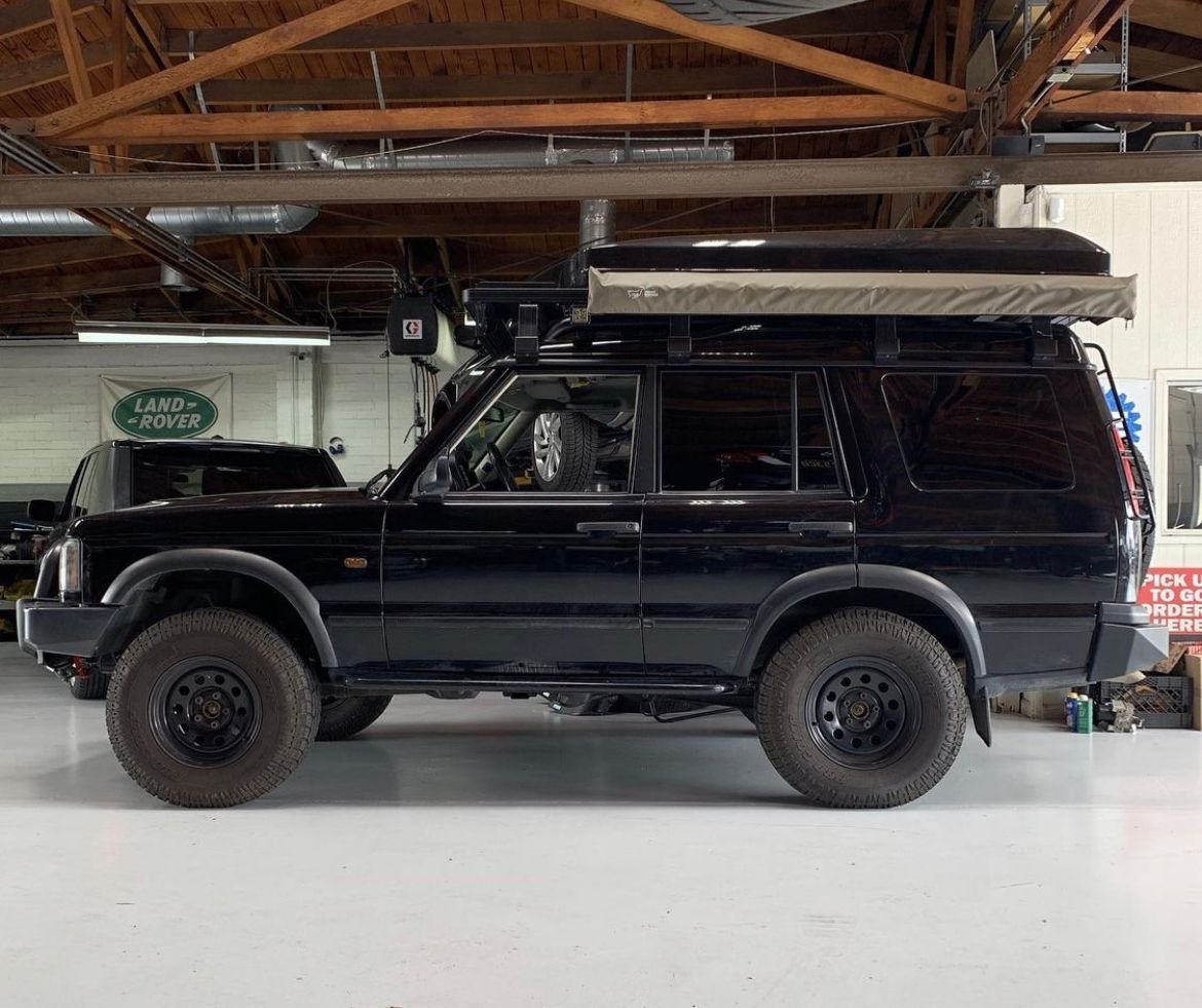

Heavy duty springs with spacers. Before and after. This is the results I want. The shop that did this is in Cali but he told me they use the OME HD with the spacers.
