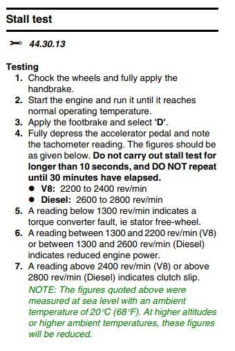

I performed stall test from the rave
Tach read over 4k rpm so very strong indication of clutch slipping. I haven't touched the transmission since I've had it, going to do a full service on it when the parts come from atlantic british. Thinking it just may be low fluid/clogged filter causing low pressure.
