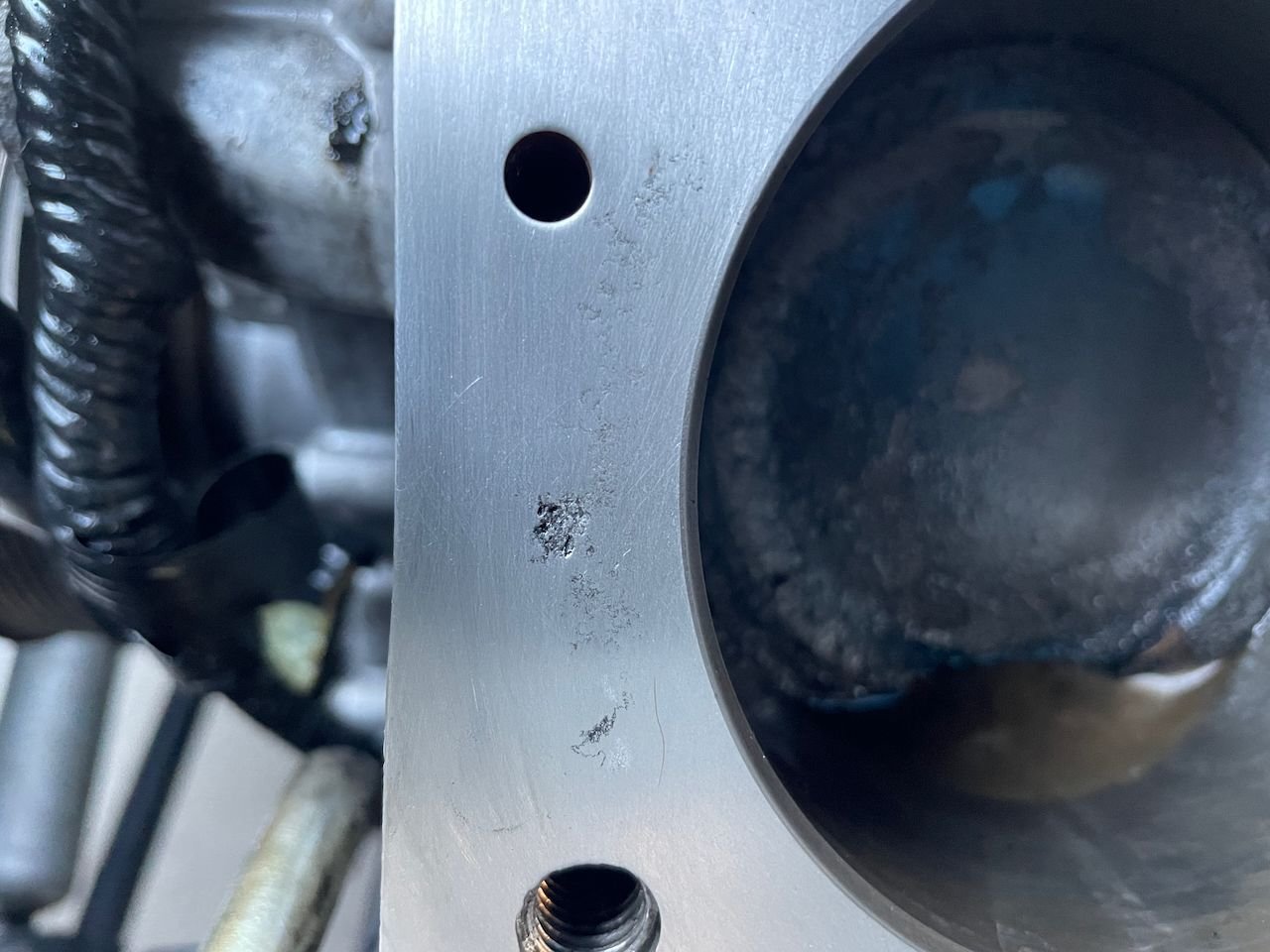

I also agree head gasket failure can be prevented. I think two overlooked things that contribute to wear is infrequent coolant changes and infrequent oil changes. Old coolant becomes corrosive to aluminum, and when I replaced my head gaskets last winter, saw first-hand what extended coolant change intervals can do to the block. Similarly, oil can become acidic if left unchanged.
