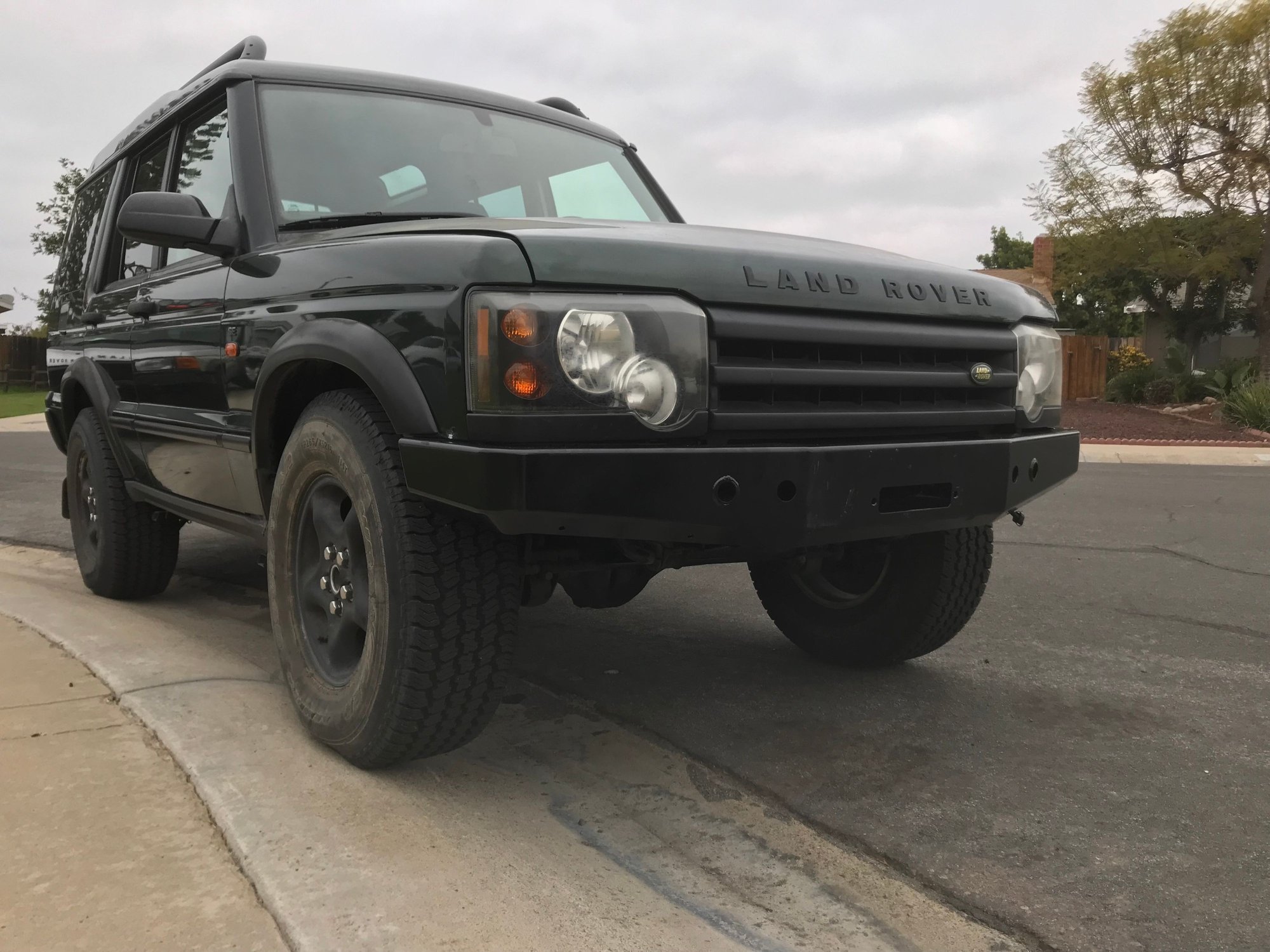

Finished product:

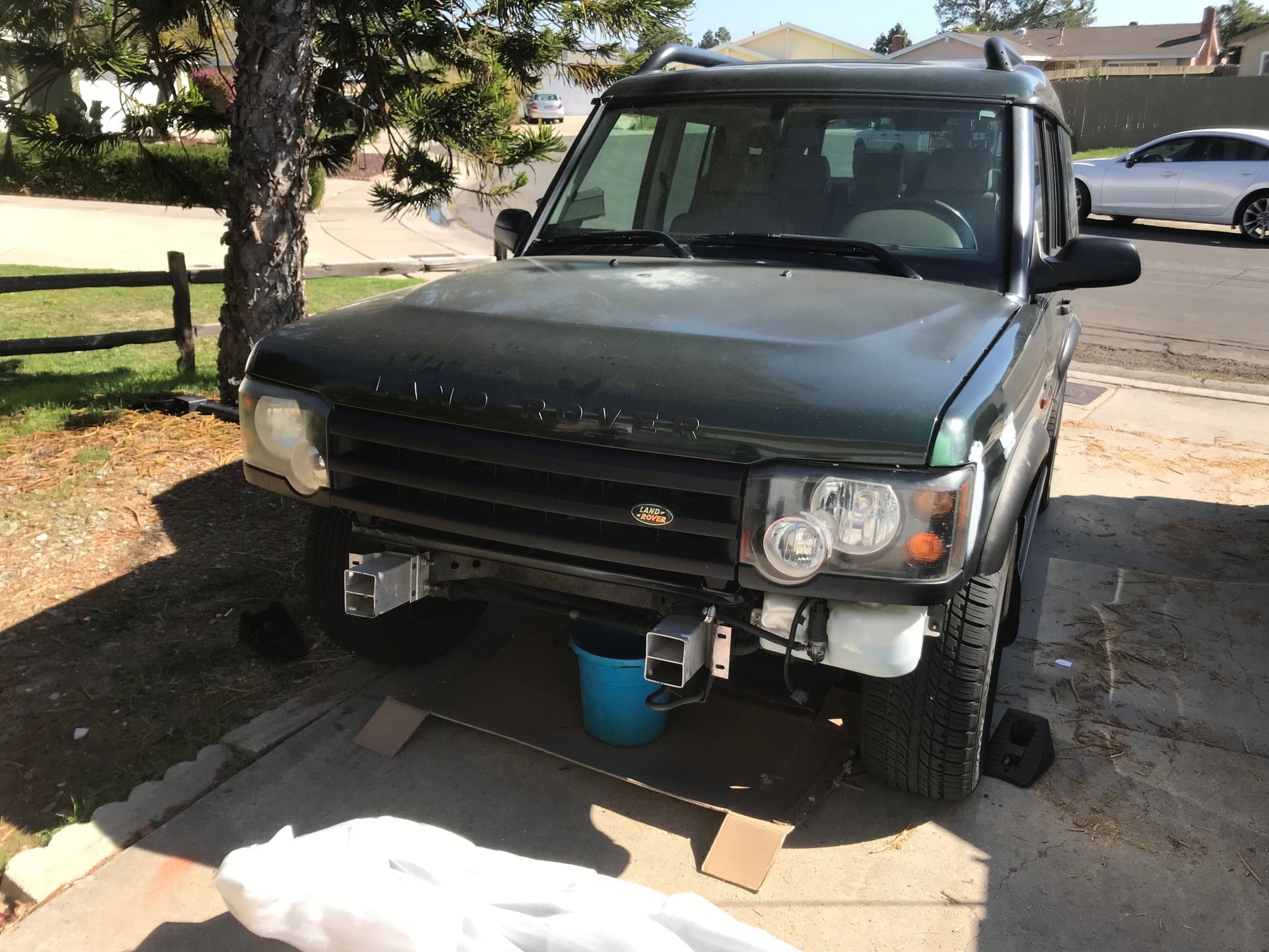

Removed stock bumper

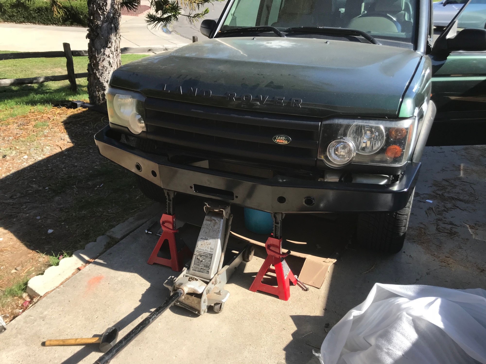

The fit was so tight I had to use a jack to torque the bumper into position. I read threads of this TF009A bumper having fitment issues and it's true. However, I can't really complain because this car has been in a fender bender.
Using jack stands and a jack to align new bumper in place

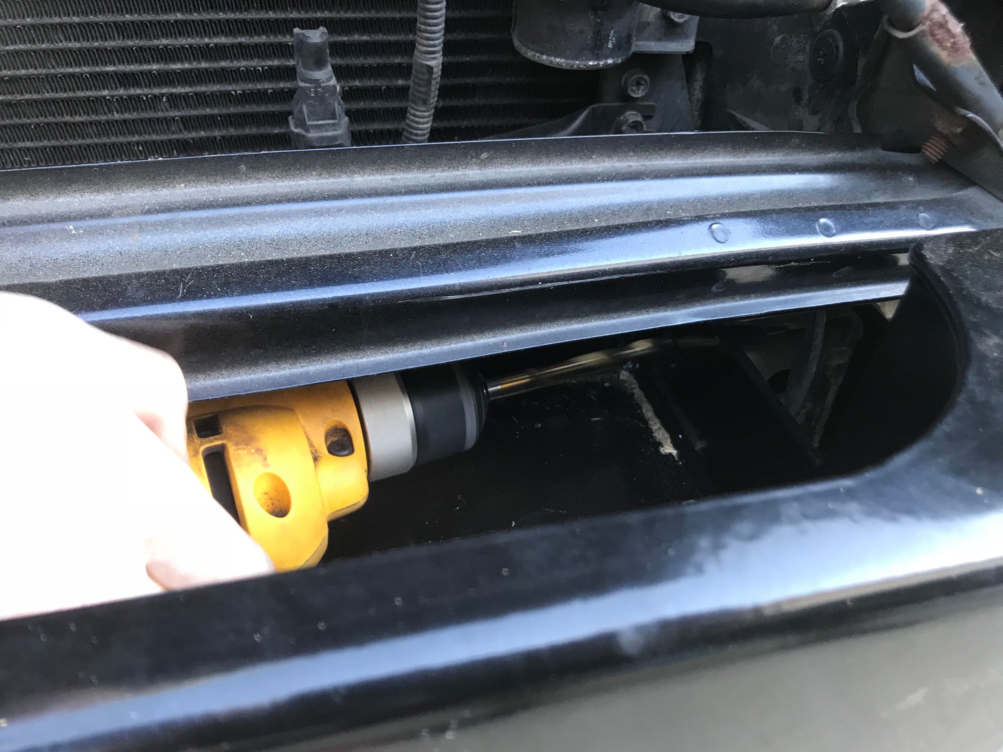

After 3 hours or so the bottom bolts were in but the top ones were still off by a hair. I ended up just boring out that extra steel with a drill because my hand was covered in blisters from pounding with the mallet.
Couldn't align it perfectly, got it SO close, but decided to drill out the rest
And finished product, overall happy with the way it looks. Pain in the a** to install though.
All done
Didn't think it was going to be that hard, not going to lie. For those thinking about purchasing the TF009A make sure your ready to muscle it in.
