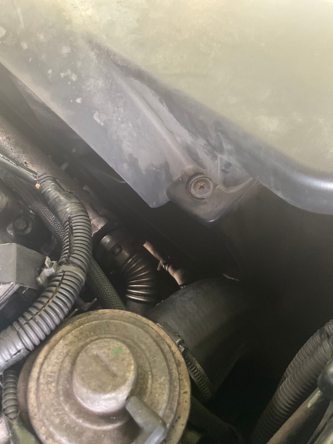

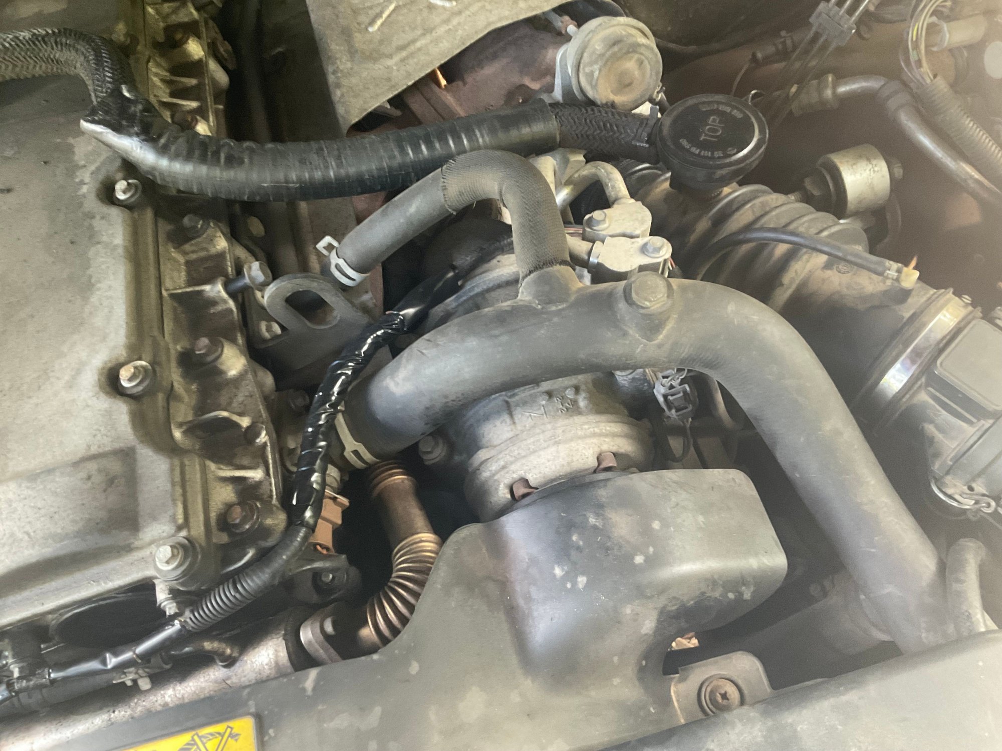

Hello all so im about to do a modification on my coolant system im losing coolant and yet to do a pressure test on the system iim hoping its just a leaky hose but i lose coolant like every 50 kms but it don’t drop all the way ,, yet , could be heather core as I’m noticing no heat blowing and fog on windscreen like residue ,
So here some photos I'm trying to fit my thermostat
the thermostat inlay project was one where you fit the-thermostat on the top near the radiator but i don’t see how this is possible my picture looks different any suggestions on how I can modify
here is a link to the mod webiste you will see my setup of hoses are different
any help be great.https://inlinethermostats.com/land-r...-2-inline-kit/

Yes, a lot of us use the in-line thermostat kit and like it. Is your kit the "Extinct" version (that's the one we use).
But, I agree that your heater core sounds suspect. Seeing your heater isn't working anyway, the easiest way to troubleshoot it would be to bypass the heater, bleed the system, and see if your problems go away.

Inline thermostat kits are for the V8 not TD5 that You seem to have.
There might have been some tests for a TD5 one by Extinct.

Oh yes, I should have noticed that it's a diesel.

Ahh thank you yeah I'll get a pressure test done next week,
Just to be sure..before I start isolating,

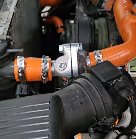

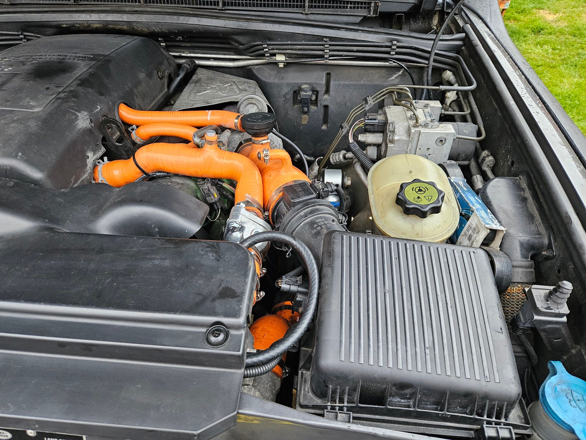

So yeah I just bought new hoses. I found it was a leak in my radiator hose. They tried to charge me for head gasket. Luckily I bought a kit to a compression myself and found the leak so now I’m doing a full upgrade of my radiator hoses. I bought the silicone kit I live in northern New South Wales. It can get quite hot here like up to 39 on some days but usually through summer third 35 that’s for four months so I think overheating is not a problem perhaps but I’d still like to keep this engine cooler because it’s done 270,000 k’s and none of the hoses have been changed so I’m now going to become a DIY Mechanic and make it happen I just bought a new thermostat and I also bought a new radiator expansion tank. I’m thinking to go to aluminium one. I do do a lot of towing so I hear there is some kind of upgrades near the radiator which I’m looking into. If there’s any other ideas guys that you think that can be good on an upgrade for these you know it’s a TD5 diesel 2003 so automatic so what has people’s experience being that they’ve done modifications to this car and probably the best things to do. I’m about to do a whole check on the engine. check the connectors redo the connectors. I bought the workshop manual so I’m gonna completely figure it out myself and try to figure out what things I should take out and replace and pretty much doing a on my TD5 in this year the next after the expansion tanks and the radiator hoses which I found out was an EGR cooler hose that I will probably go to the AC
and saying that I have now collected the rings to put around the hoses which are called clamps but I am thinking to upgrade them to T clamps. Apparently the T clamps are better for the radiator hoses especially because it gets quite hot. I really don’t know what else to do right now but I feel like there’s so modern and replace on this car cause none of it’s really been changed since it’s been handed over to me five years ago so I think it’s time to start really working on the engine itself and get them all. Schmick
also extinct are you saying that you have done a TD5 model upgrade of the thermostat and not just the V8 ones?

Yes, we have done TD5's before and I just received the first batch of photos from the customer. Works just as good as the Petrol ones. We are now working on getting it on the website and writing up the installation instructions. In the meantime if you are in a hurry order the standard kit and message me directly you want the TD5 and I will send it.
You may also want to take a look at our electric fan kit. I have not validated it on the TD5 but it could be done so pretty easily. We provide the brackets and wiring harness to integrate it, the fans are stock oem fans. You could easily test by ordering the fans off amazon to start and then see how if fits on the TD5 radiator, if it fits good just go ahead and order the kit for the wiring and brackets. Start here, be sure to click on the links, the videos, and the blog post: https://extinctmotorsports.com/dual-...tallation-kit/
