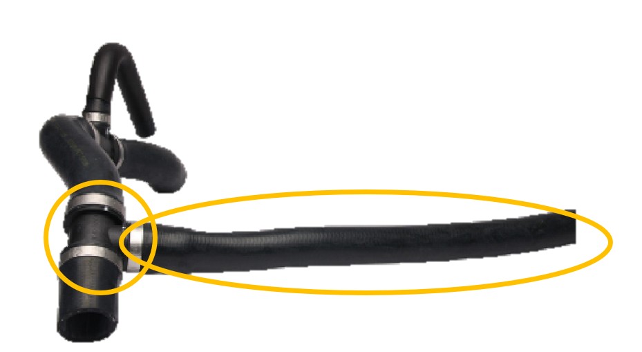

I see so it kind of looks like it would fit in a TD5 but you know my thermostats underneath so that looks like it’s going from the radiator to the engine top radiator hoses. I assume that would work I don’t know but yeah I don’t need one right now but I’d be looking into it for sure. Do you have any schematics or manual towards setting something like that up so I can get my head around? It

The TD5 uses the same basic design from factory that petrol engine does except hoses are lower and on left side. Steel bushing goes in place of factory thermostat and inline thermostat goes in top hose. Bypass hose would need to be eliminated. So on this hose we would eliminate the tee and the hose that goes down to the thermostat and install an inline thermostat in the place of the tee.
