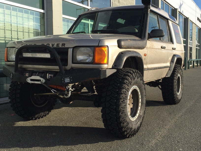

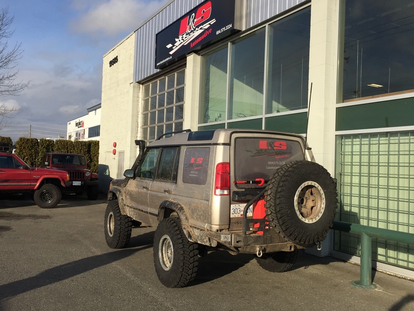

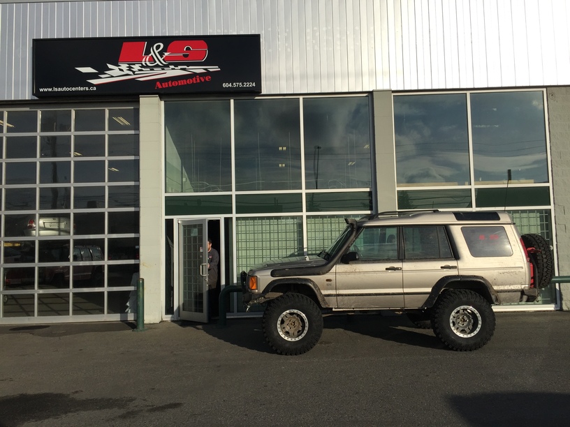

Well the disco has made a few changes since I finished the bumper finally almost have her done the rovertyme lift with bilstiens all around is in the Air lockers gears and axles are in front bumper is finished rear bumper is almost finished took the 35s off and I stuffed 37s under her gonna do some more trimming this weekend so I can get full flex back ...I am shocked at well this truck drives on the road and amazed how good it is off road ...Let me know what ya think

That's awesome, I've been making plans to fit 35s on my DD '03. Do you have a build thread or a full list of the modifications you've done? Super awesome, man.

Thanks sorry I didnt do a build thread dont have the free time to document everything ..as far as mods go it has a rte 4 inch lift that actually raised it over 5 inches rte arms front and rear rte watts link( soon to be swapped for a pan hard bar ) bilstein remote reservoir shocks gbr gear set gbr driveshafts ARB air lockers front and rear cdl t case a built by me front bumper 12000 pound winch A heavily modded jeep jk smittlybilt atlas rear bumper done by me.. fuel custom made true bead locks and the tires are 37x12.50/17 challenger competition tires ...oh and a ebay snorkel and a **** ton of body trimming lol more to trim tomorrow to get all my flex back after putting on the 37s I was running 35s for the last year just put the 37s on yesterday. I have a few pics from the build up but not many there is a thread on here about my front bumper build ...

I thought that looked like more than 4 inches. Damn.
What gear ratio are you running? Stock axles? Very cool rig.

thanks Alex I am using gbr 4.43 gears and ya stock axles for now ...

Thanks guys sorry Rawfaith no plans for the bumpers I kinda just designed it as I went along and as far as the rear bumper goes that bumper was a smittybilt Atlas bumper designed for a jeep jk that I modded and made fit ..as far as serious investment goes its all worth it I take my kids out wheeling in it almost every weekend they love going so makes it all worth it ....plus owning a automotive shop and having all the welding fab equipment at my disposal definitely helps...got all the trimming done today hopefully I clearanced enough gonna try her out tomorrow ill attach some pictures in the morning
