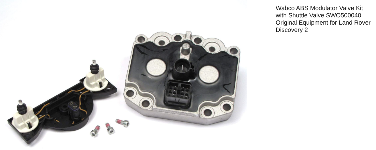

Seems to me the comments to repair option B are very often together with crumbled insulation of the wires. Makes no sense to me. The simple circuitry I see is :
Plug pin1--------------------------------Solenoid1----------------------------------Solenoid2--------------------------------Plug pin2
The plug is internal, brought by the outside for a more reliable and visual reach as you say. If there was no insulation at all, the connection still exists to the solenoids. If the firmness of the plug connection fails; then I understand the need for surgery.
If continuity is probed from ground to the terminal at the modulator plug that connects to the end solenoid and shows proper resistance of both solenoids in series, would the option B surgery be needed ?
Is the firmness of the contacts of that internal plug the unreliable one, that is modified by soldered joints instead ?
" I have never seen a failed switch" --- ¿ Are these switches actuated by hydraulics or solenoids that actuate hydraulics ? Or electrovalves ?
At ----> https://www.roverparts.com/resources...-discovery-ii/
Time stamp 1:08 is "solenoids"
Time stamp 2:13 is "shuttle valve"
Did not see a place when named "switches"
I hope the Wabco company learned a good spanking lesson from their unreliable brakes engineering in our cars and will never goof again.
Robbery.

The internal PCB is what cracks and causes the 3 Amigos within the Wabco Unit itself. The insulation is just a side effect of old age. Heck I have honestly used some 3/32 heatshrink and placed it over the crumbled wires on a stock shuttle valve switch and then performed Option B to a perfectly working system. After Option B is performed your only faults will be the ABS sensors themselves.
