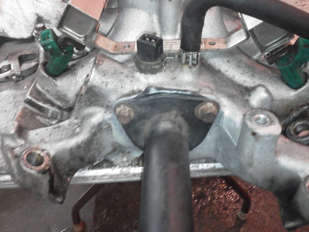

Anybody have any pics of where the hose from the throttle body goes down into the block? I cannot see down in there, looks like it just goes down in the the black hole. I have seen the sketches, but wondering what all has to come off to get to the inlet where the hose attaches to remove/replace the that short little hose coming from the throttle body?

Does this help? Also have cutaway drawing from RAVE attached.

I was changing the throttle body heater pacl and while pushing the OLD and BRITTLE hose that goes into from the pacl to the block the whole thing borke off. After cutting open the hose, yup, the rusted nozzle (nipple) was still inside.
So ANY SUGGESTIONS as to how to deal with a hole dissapearing into the block? If I put sealent and a bolt and completley shutt off this coolant looop, will I cause huge problems?
Any thoughts welcome. Thanks to whoever was putting water in here instead of coolant.
