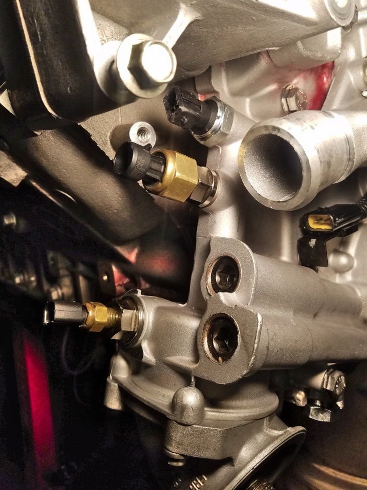

www.inlinethermostats.com What year? 03-05 I would use the port the oil cooler line threads in to. 00-02 I would use the next port up, or tee in to the port where the factory switch goes. Some guys like to use a screw on oil filter adapter.

I installed a pressure sensor in the port of the pressure switch and moved the pressure switch to upper port which is plugged from factory. Plug is easy to remove. Most sensors have an NPT thread, so you need an adapter to the metric thread of the port (M12x1.5 to 1/8" NPT). If you remove the alternator bracket it will be much easier to install.
