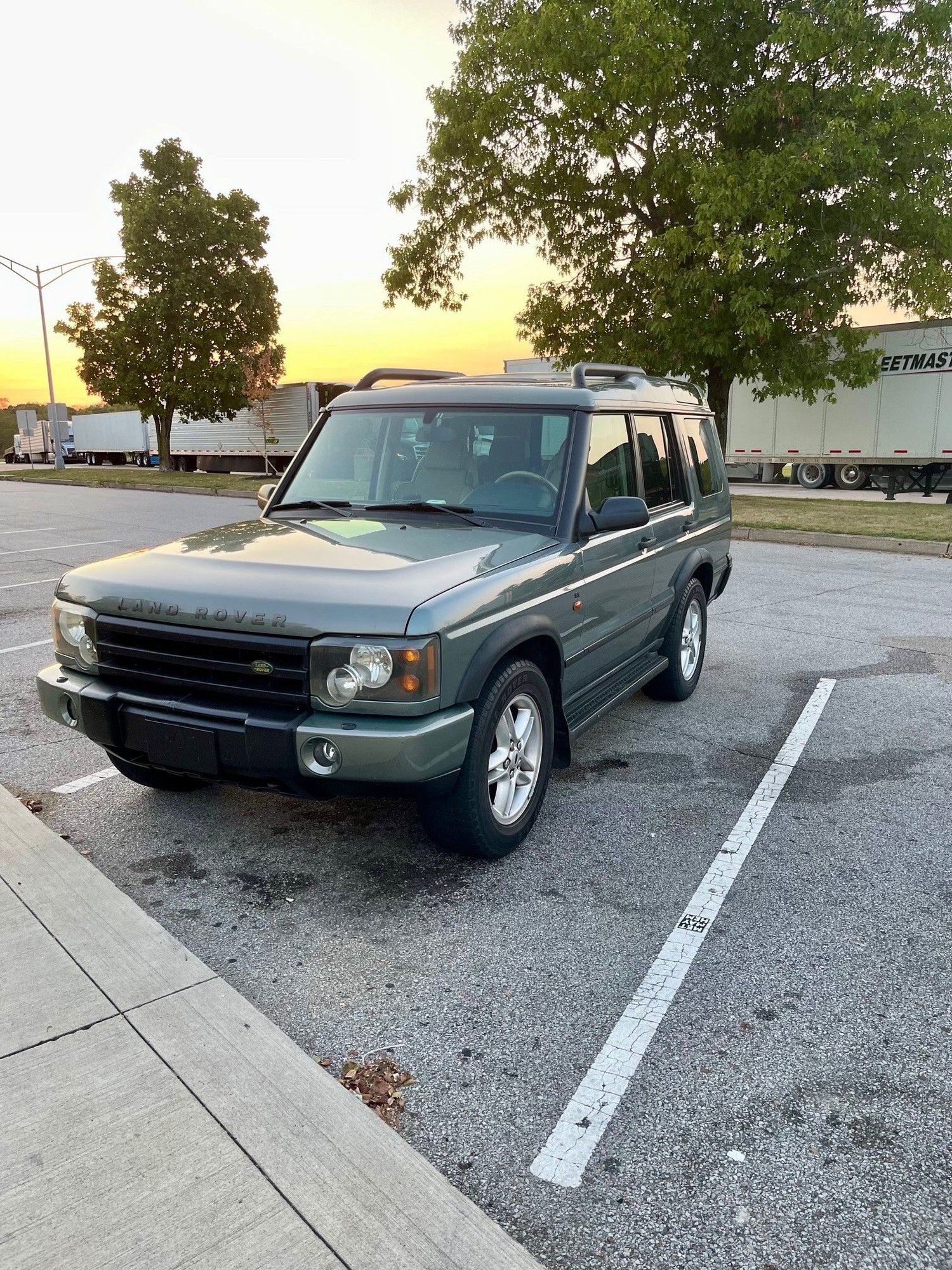

Thank you! Thrilled to finally have one after stalking other people's for so long. Here's a picture from the ride home (I think she's Giverny Green but I'm colorblind so it mostly looks gray to me);

Pretty truck. I'd ditch the running boards though, lol. The lucky8 thermostat is for the LR designed system which is part of the problem. Extinct's setup bypasses this for a better more traditional-designed cooling system. He can provide more details or read his link above. I don't think the original cooling system is completely flawed, it just doesn't allow much margin for error if something is off or goes sort of wrong. And when that happens the temps can skyrocket very quickly.

Thanks! I'll be getting rid of them either this weekend or the next, hopefully it won't be a too much of a pain. Looks like I'm going for Extinct's then!
