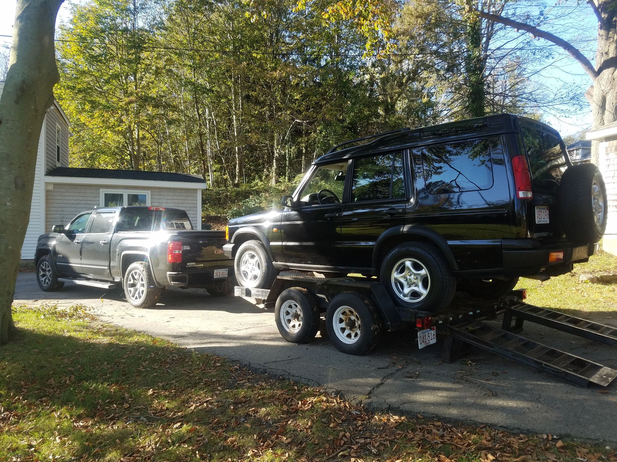

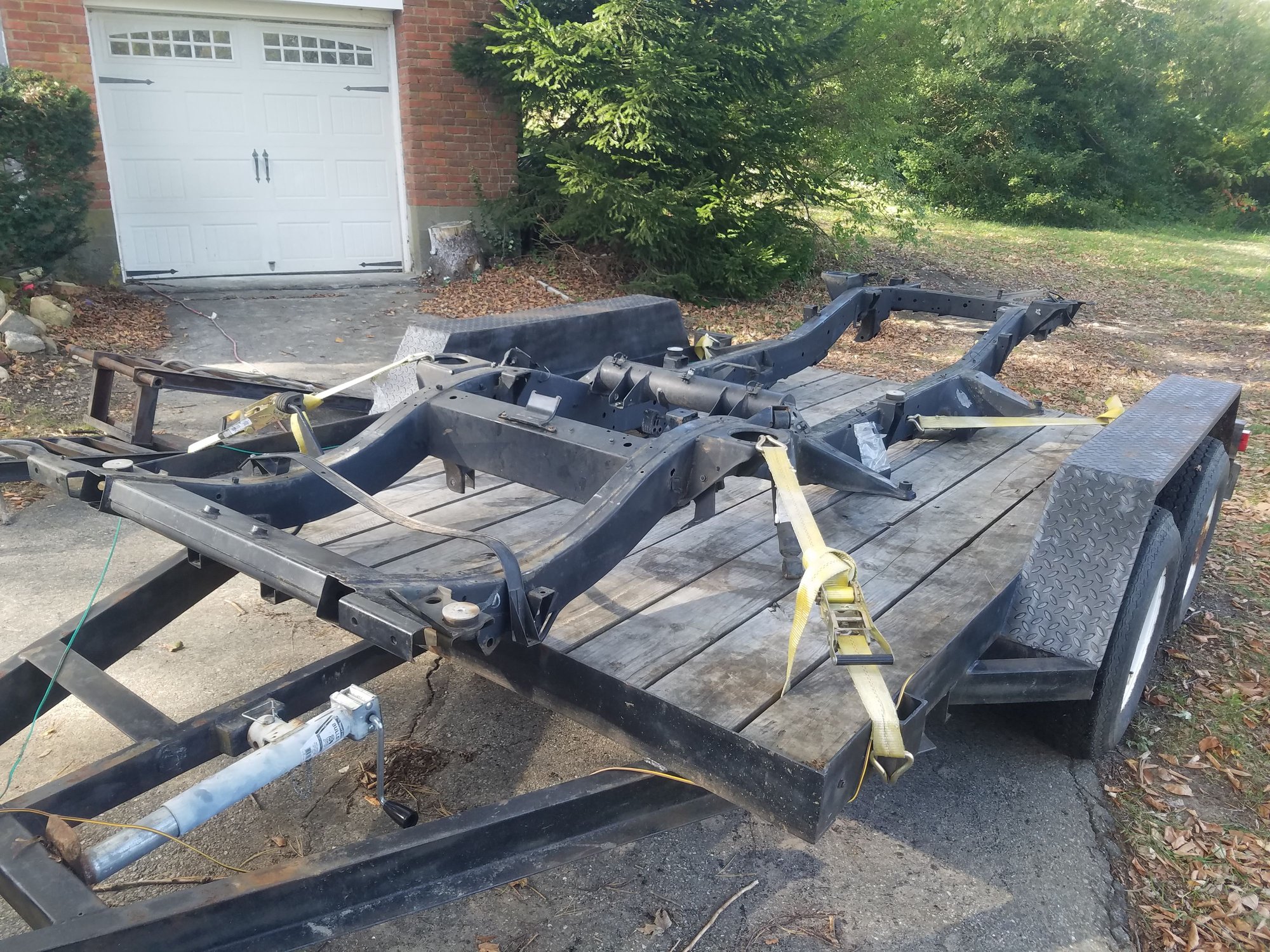

Got the frame today...
Here's a picture of the Rover it's going under...
