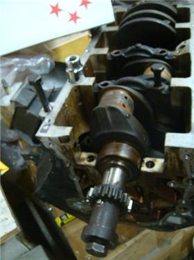

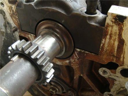

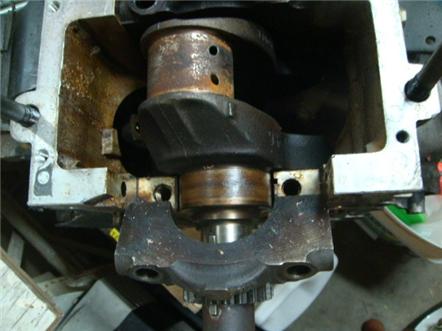

So here are some pictures of the crank shaft on my spare 2004 4.6L block. It was amazing to me to see there is no bearing that the crankshaft runs on. This would be your engine turned upside down. The oil pan would attach over this section sticking out of the block. There is no front cover on the engine block. Its a 24mm bolt that holds on the harmonic balancer. I guess with each revolution of the crankshaft it would dip into the oil pan and lubricate itself. It always amazes me the metal parts that contact each other with only oil to lube them.
