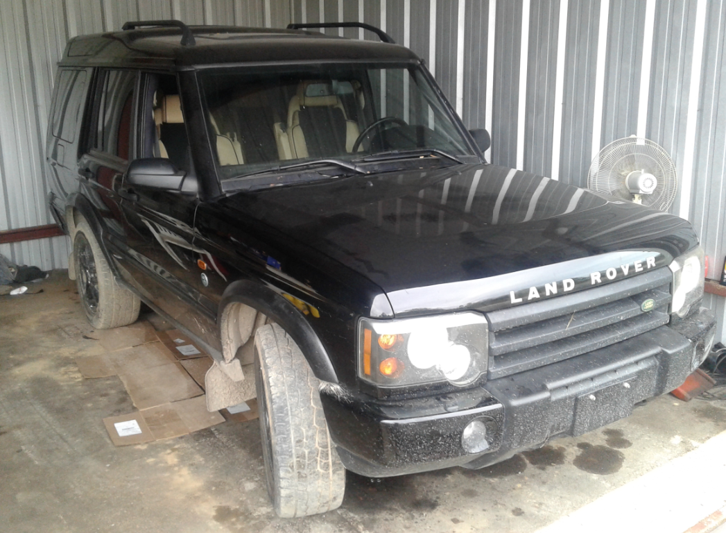

From: Alabama + Vegas + Texas
Put the hood back onto the Disco finally. All road worthy.
