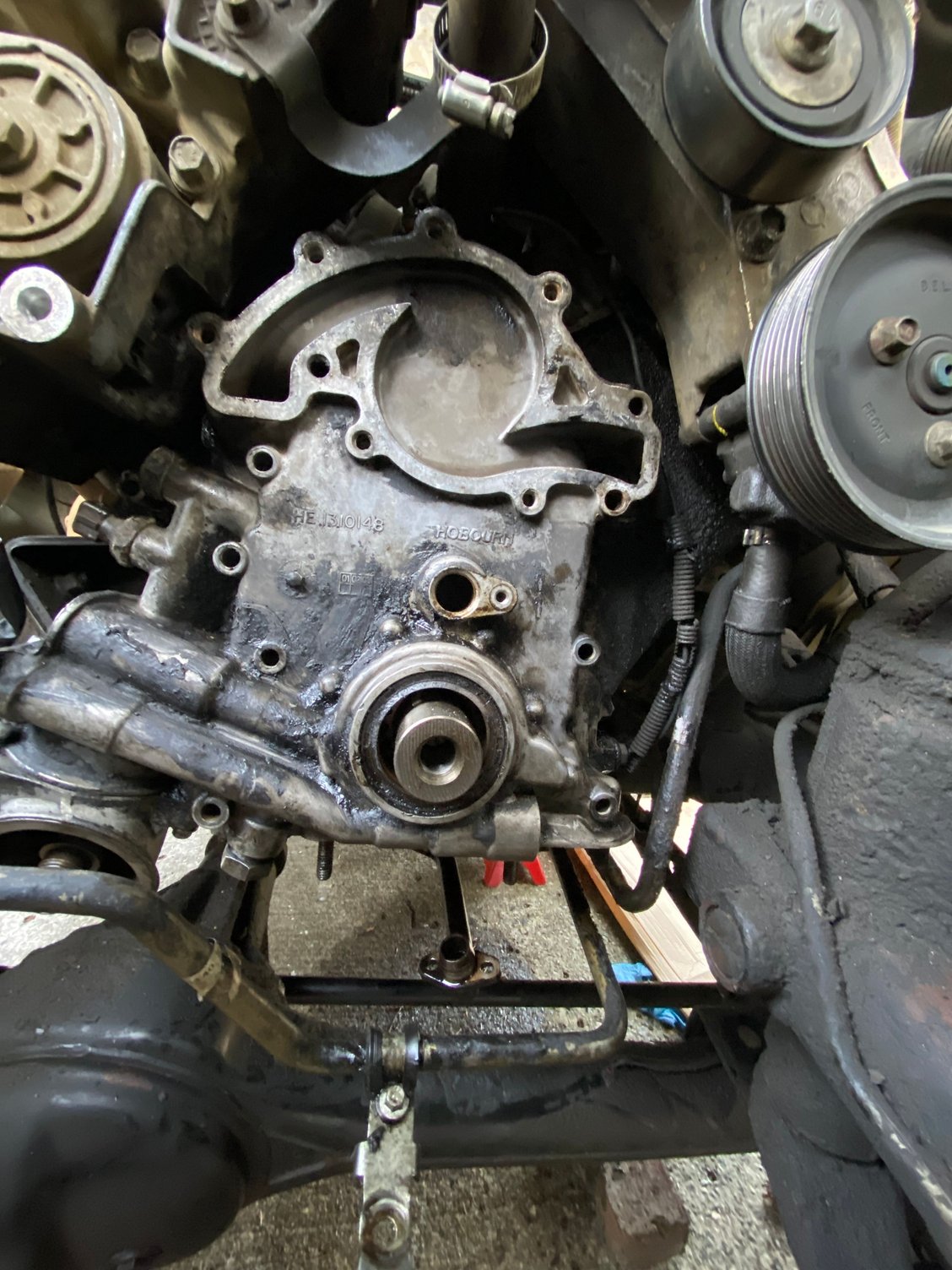

So I removed the oil pan and all the bolts from the front. The cover move a bit from the bottom but seems stuck on something at top left (when seen from front). Any idea what I could be missing?

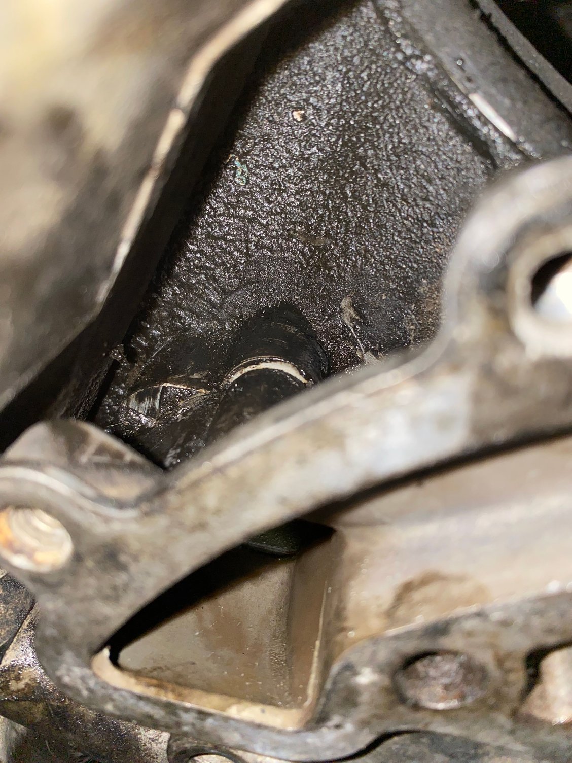

In the close up photo it seems to be stuck at the stud in the back

Sounds like it has seized onto the alignment pin. I would just keep prying at that point, or tap a wedge in there.

Thanks. I will keep trying.
do you think penetrating oil will help?

Agentle warm with a blow torch or even your wife hair dryer, to expand it a few thou normaly works

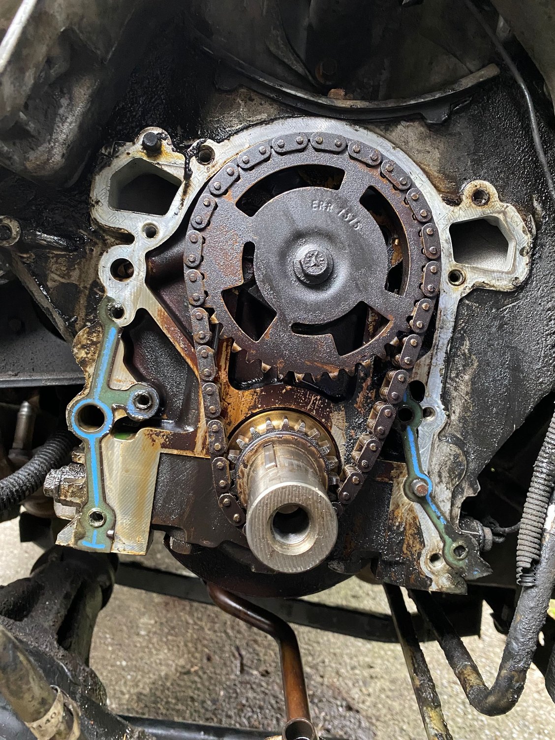

Thank you all for the suggestion.
I was able to succesfully get the cover off by using a combination of heat (hair dryer !) and penetrating oil.
see pic on the timing chain condition !!

well done some time its the simplist metods that work
