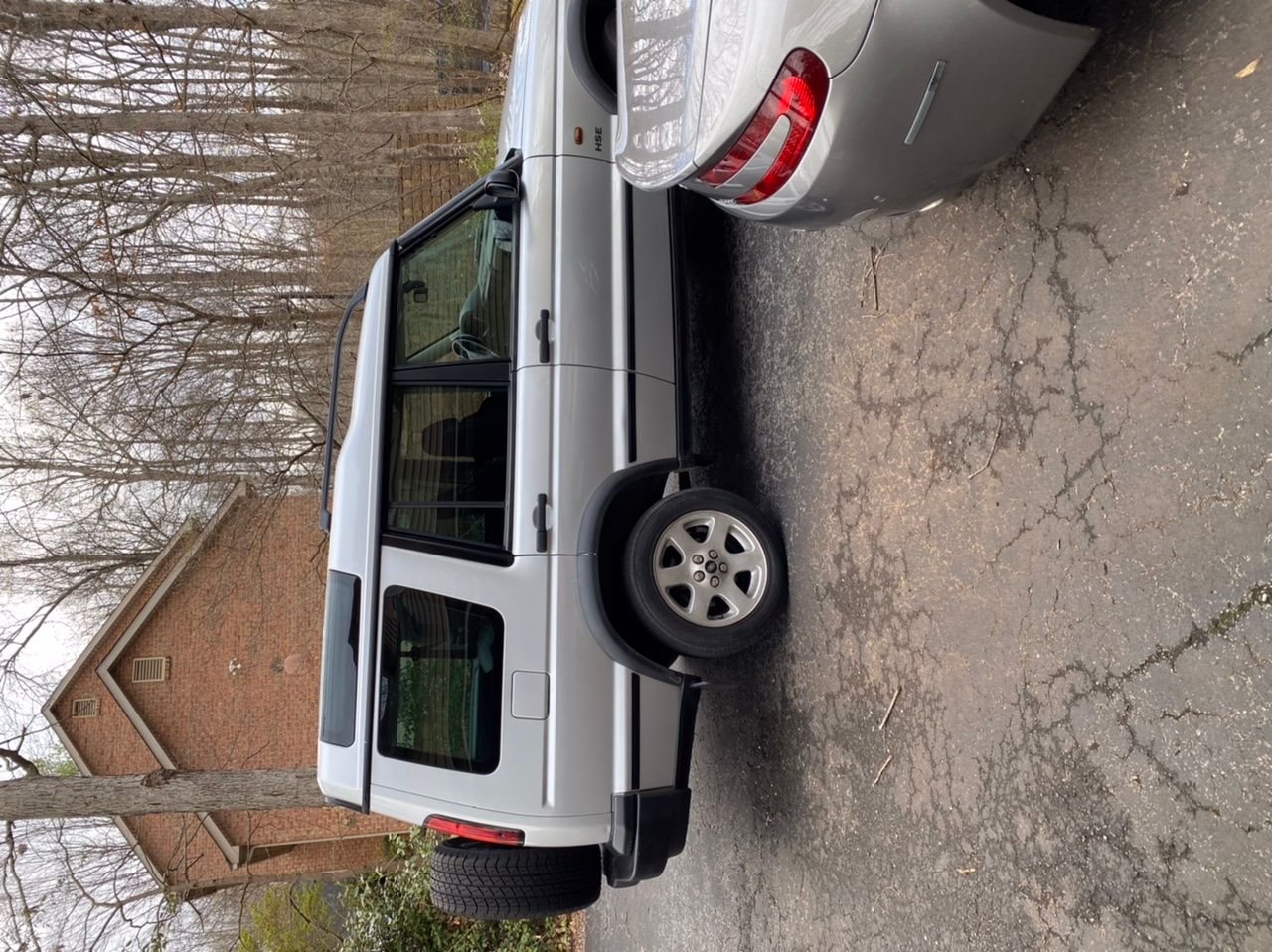

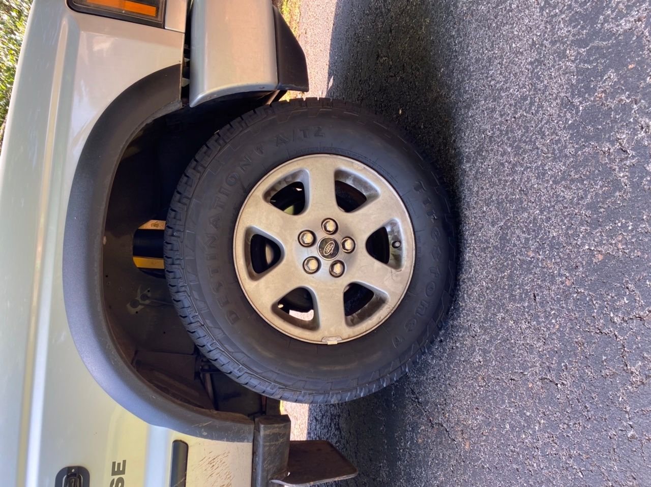

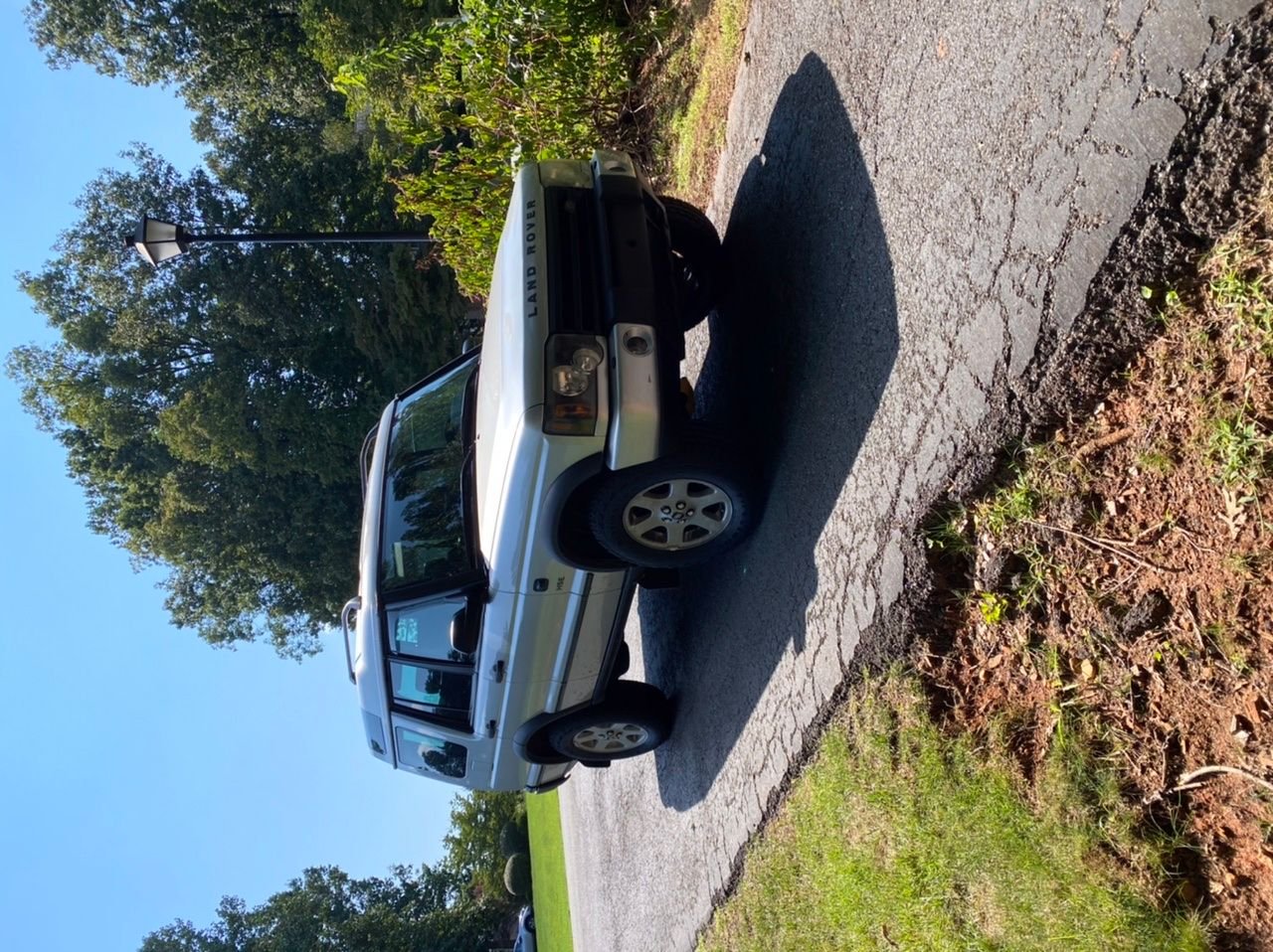

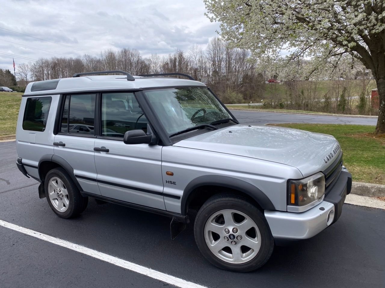

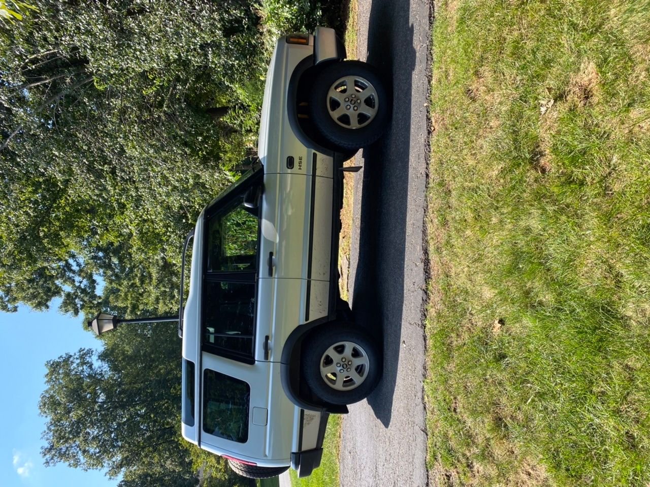

Hi, weighing in a bit late, but have some pictures to share - before and after. First is completely stock (2003 HSE) with 255/55-18s. Then one or two shots with original tires, RTE Fab HD springs, medium duty OME shocks, new poly bushings all around and HD shock towers. Finally, a couple with 275/65-18 Firestone Destination A/T-2 tires fitted. Have experienced no rubbing issues;
Original tires and suspension
Installing 2” lift - original tires
Lift and new tires
Lift and new tires
Close up -lift and new tires
tires are relatively quiet on highway.
