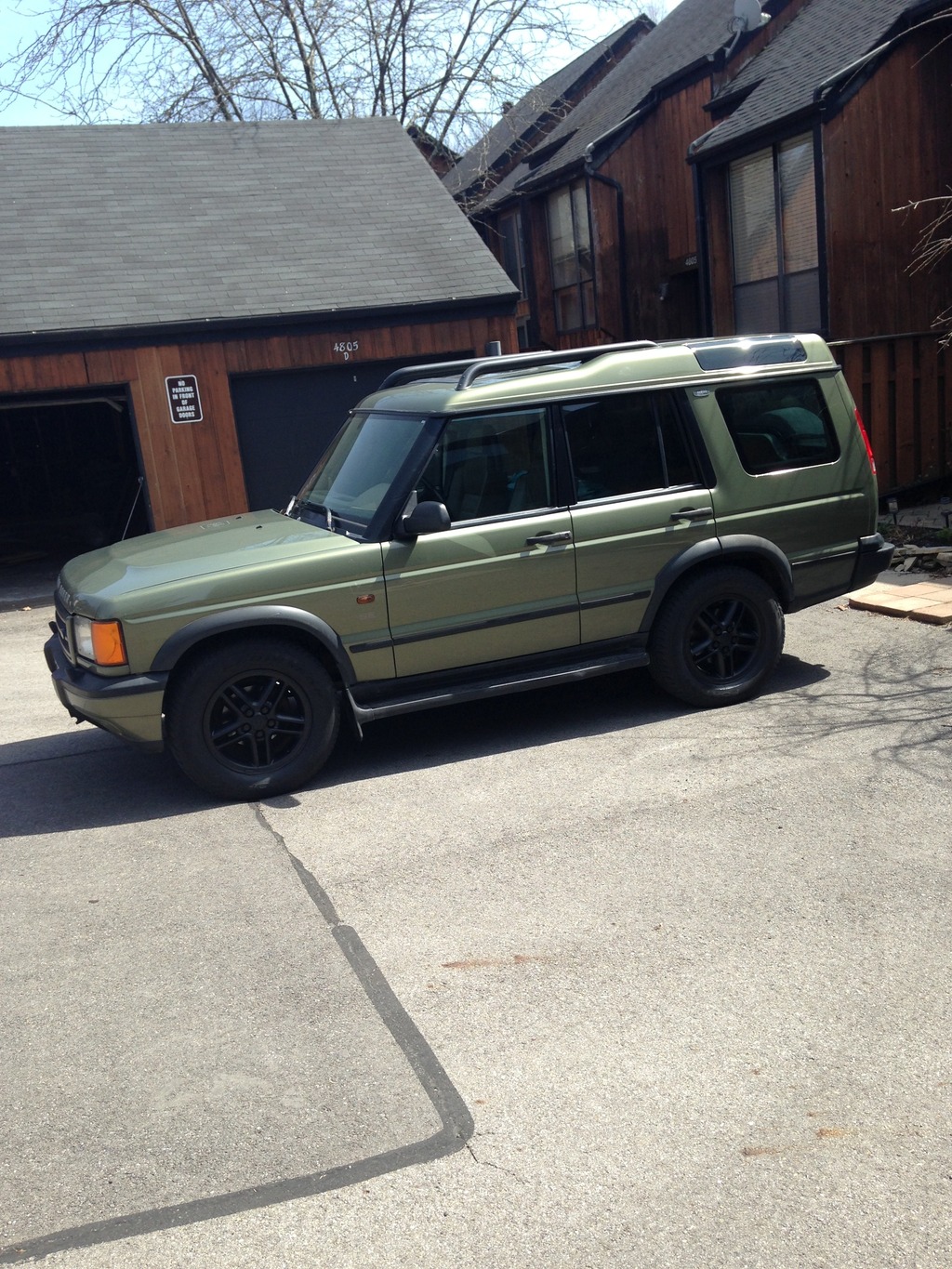

3 inch lift with 275/70/18's. It looks awesome and if you only go with 2 inches of lift you will wish you had gone 3 down the road. The BFG AT's are only $216 shipped! But prices in your neck of the woods may vary.
Just look at this damn thing!
