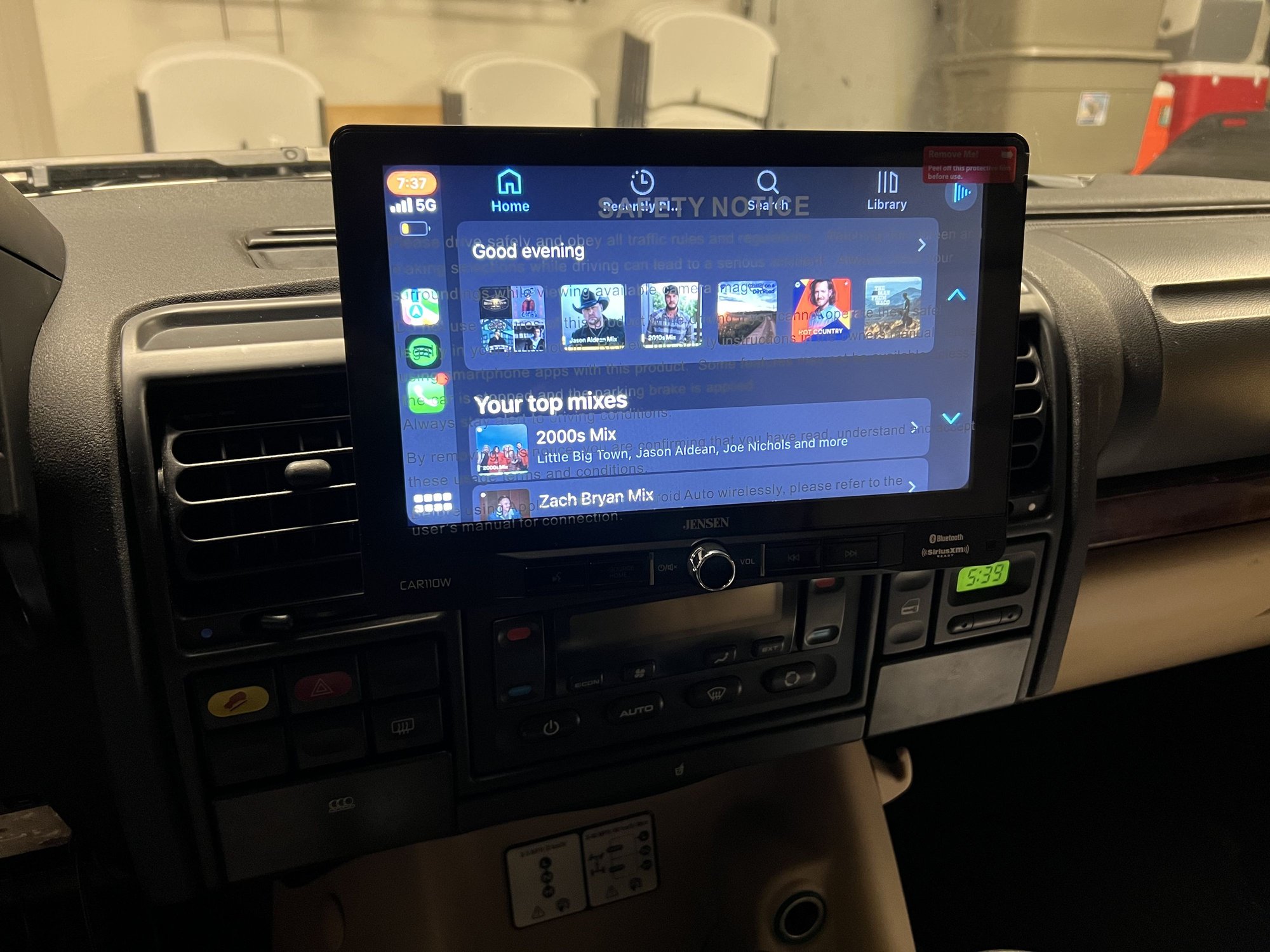

I installed the Jensen CAR110W and its great. I have the HK system and with the Metra 70-1786 adapter and the PAC SWI-CP2 kit for using steering wheel controls - it took me about 2 hours from start to finish. Sounds a ton better, no feedback or pops, steering wheel controls all work and it has wireless carplay - so it connects within seconds of turning the key.
best non-drive train $500 I have spent on the Disco.
Even forced me to work on upgrading the rear subs because it works and sounds so much better - I suddenly enjoy listening to music in it...
Jensen CAR110W
