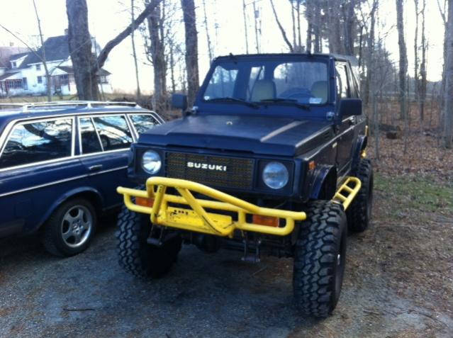

Yeah, it's smaller than that.
1986 Suzuki Samurai, 84/85 Toyota Axles, w/ Jeep YJ springs, 6.5:1 transfercase gears.. Crazy little truck. It really doesn't weigh very much, and at 60mph on the highway is a white knuckle adventure, hence wanting to tow it.
