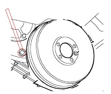

You can try this
http://www.discovery2.co.uk/transferbox_oil.html
or using the 1/2 ratchet by its self in this position as in the picture.

yeah ill try the ratchet upside-down trick... will let ya know how it goes.

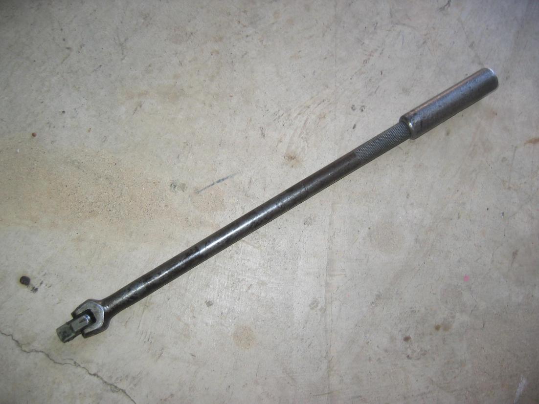

I just changed he fluid in my T-Case a few weeks ago and this tool worked great. I just moved the E brake cable out of the way and it fit perfect.
