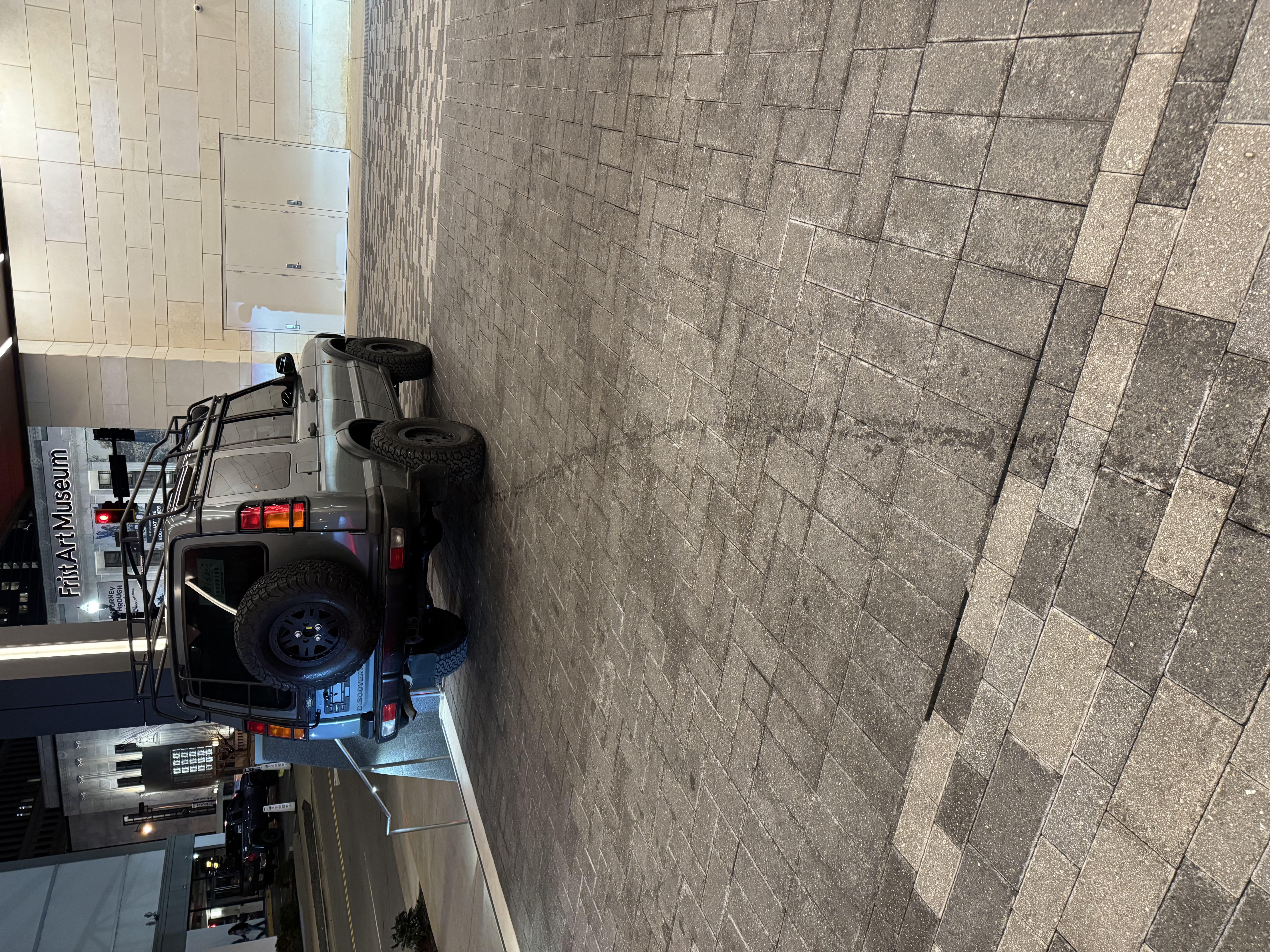

Anyone got any ideas what this is? Just finished a road trip and noticed this.

Man, that is not good. Never seen that before and I have had 25+ trucks. Most likely either cracked torque converter or bad front seal, either one requires the transmission or engine to come out. How many miles on the truck? Any other work need doing? Engine out lets you fix trans as well do lots of things to the engine easily.

it has 155k miles but just had a reman AB engine go in about 1k miles ago. I’ll give an update on when I find out what happened. Sounds like it might need a new transmission as well.
