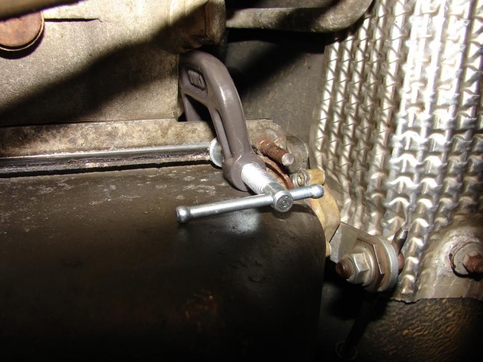

As promised...
A picture says a thousand words...

Old Nov 7, 2010 | 01:29 PM

Oh....so by "I don't have enough room" you actually mean "unless I take the pan back off."
Yeah...you can try some other things, but I find that bolt extraction is nothing to play around with. I always prefer to get the best angle with the most surface contact I can on things as to avoid larger problems when quick first attempts fail.
Wish you the best, but I'd sugest doing it the long but correct way.
