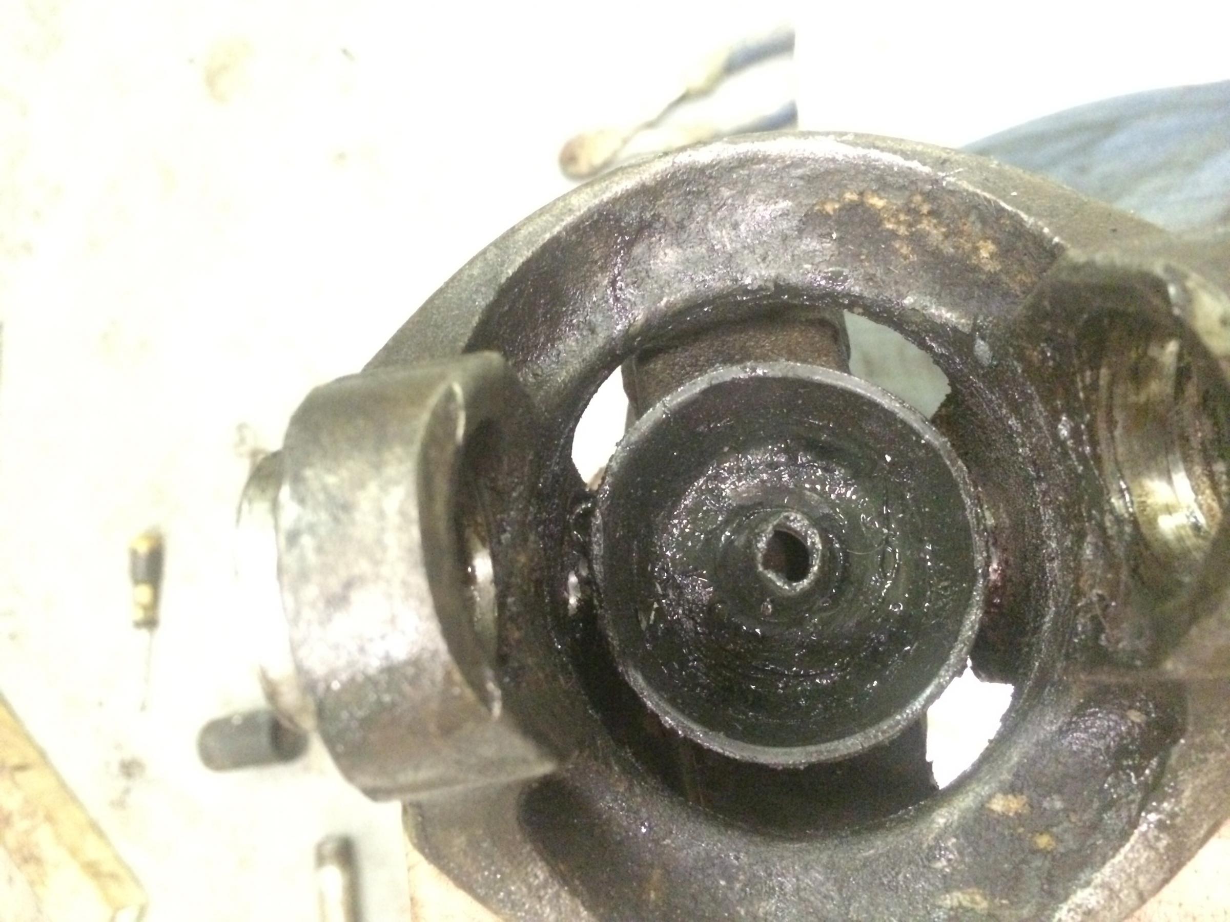

So after my last post I begin to retrace my steps and realized that the only other thing involved in a click and drop it in the revolution of the tire outside the differential would have to either be axles for driveshaft because it wouldn't likely be in revolution with the tire in the transfer case.
So to recap, I have both axles out have a true track apart I have the site plate off the transfer case all to find this issue. The first thing I did to get to this point was remove the front driveshaft. I had visibly inspected and physically manipulated the driveshaft several times to make sure there was no issue there. This is an HD driveshaft it has less than 10,000 miles on it and I have greased it probably 20 times since I've owned it. I grease it every time I change the oil. I grease it every time I go wheeling and every time I get back. I am vigilant about greasing the centering ball as well. I have two cases of locknuts from Fastenal to make it convenient. I've gotten quite good at it I can drop the front of the shaft have it greased and back up before my oil finished draining.
So now I have torn the gaiters off of my Cvs, cleaned all the grease out to inspect. No problems there. I have the crossmember sideplate and exhaust Y pipe off in preparation to drop the tcase. I move my axles out-of-the-way picked up my driveshaft to inspect it one last time before I crawl under for removal. I thought well even though it all seems well I will go ahead and pop off the U joint to get a better look at the centering ball
There's a little something missing from these pictures.

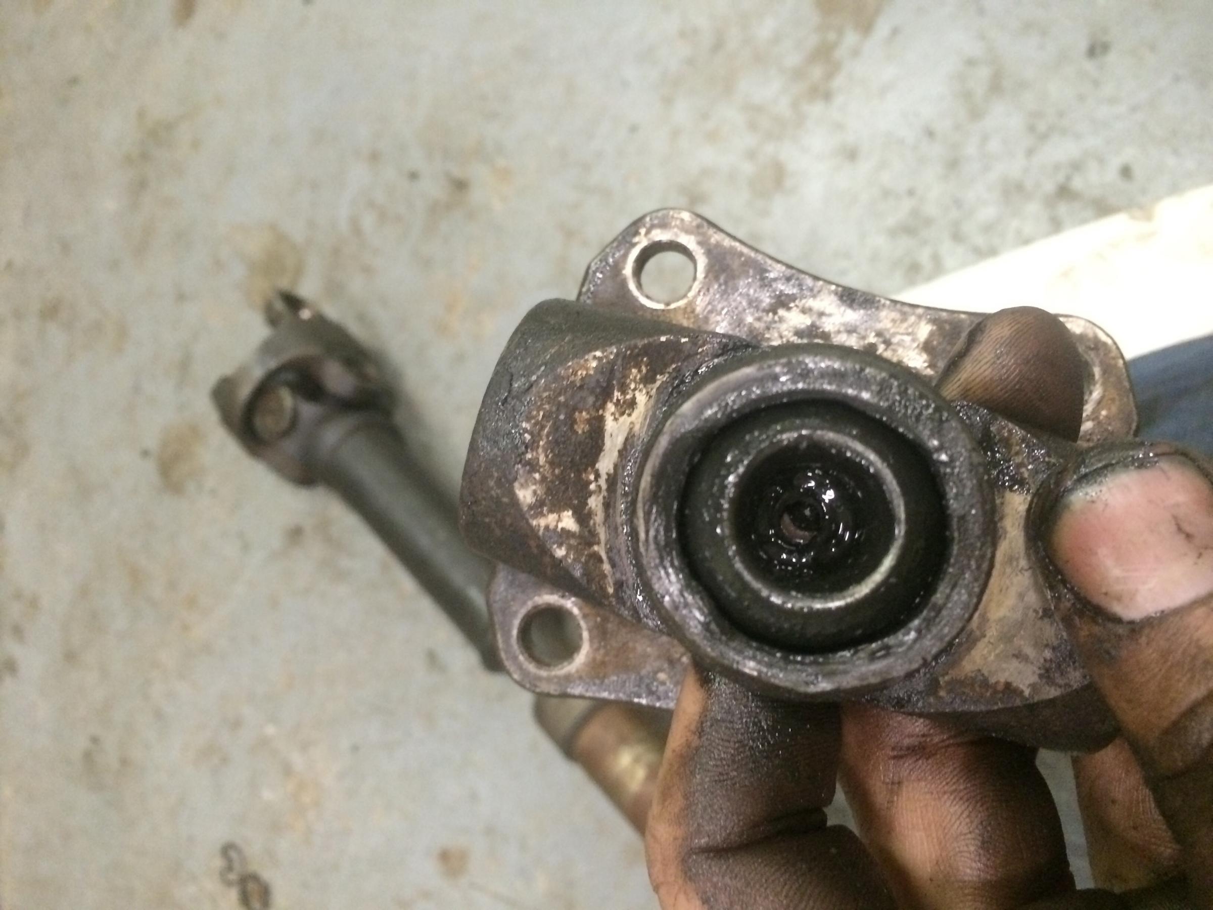

And where's the spring?
Still has grease

Originally Posted by dusty1
Holy stupid monkey head!!!!!
Hiya monkey head yep where's the spring? Résultats Google Recherche d'images correspondant à http://www.thedieselstop.com/forums/attachments/f24/11788-99-f250sd-7-3-2wd-drive-shaft-vs-4wd-drive-shaft-142-wb-rear-ds.jpg either it's disintegrated or they never fitted one.

Sadly, I suspect the latter.
still had grease in it, from my pre-trip lube job
I feel like I just played a horrible prank on myself
Oh well, you live and learn.
By the way I will not point fingers at the company that produced that driveshaft as I do not know for certain why there is no spring. I will say that it's not a Tom Woods and it's not a GBR so........
