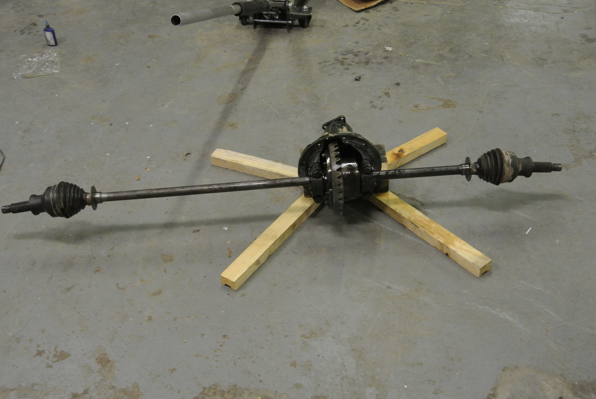

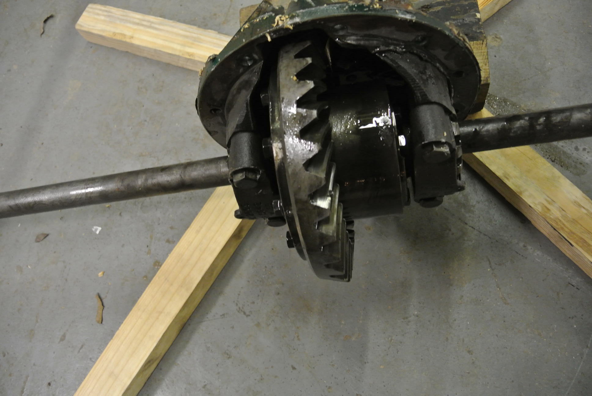

Yeah
I'll yank the case apart
Still a bit curious on what to look for in the tt. Do I need to pull it apart?
gobble gobble to you
Attached Thumbnails troubleshooting driveline-dsc_5399.jpg   troubleshooting driveline-dsc_5400.jpg

Your trutrak has a half dozen gear inside of it. Check on eatons website I'm sure they must have exploded veiws

Firstly drop off the tcase cover, think it's eight small bolts/screws. Check the shafts and bearings for lateral movement/wear. It may be worth dropping the tcase and checking out the 1x input seal and 2x output seals and replacing. Also the 1x autobox output seal. (Don't get ya digits trapped between the Tcase and floor ............. painful. it's circa 55kgs)
Check out the truetrac for gear damage or broken pins.
Checkout the crownwheel and pinion bearings for damage and wash down and blue off the teeth on the crownwheel and operate the pinion to see whther the mesh is correct.
All ya need to know about diff builds except the trustrac. http://www.ashcroft-transmissions.co...ype-diffs.html shows how to blue off and mesh contact patterns. Jump to it Dusty, ................... simples

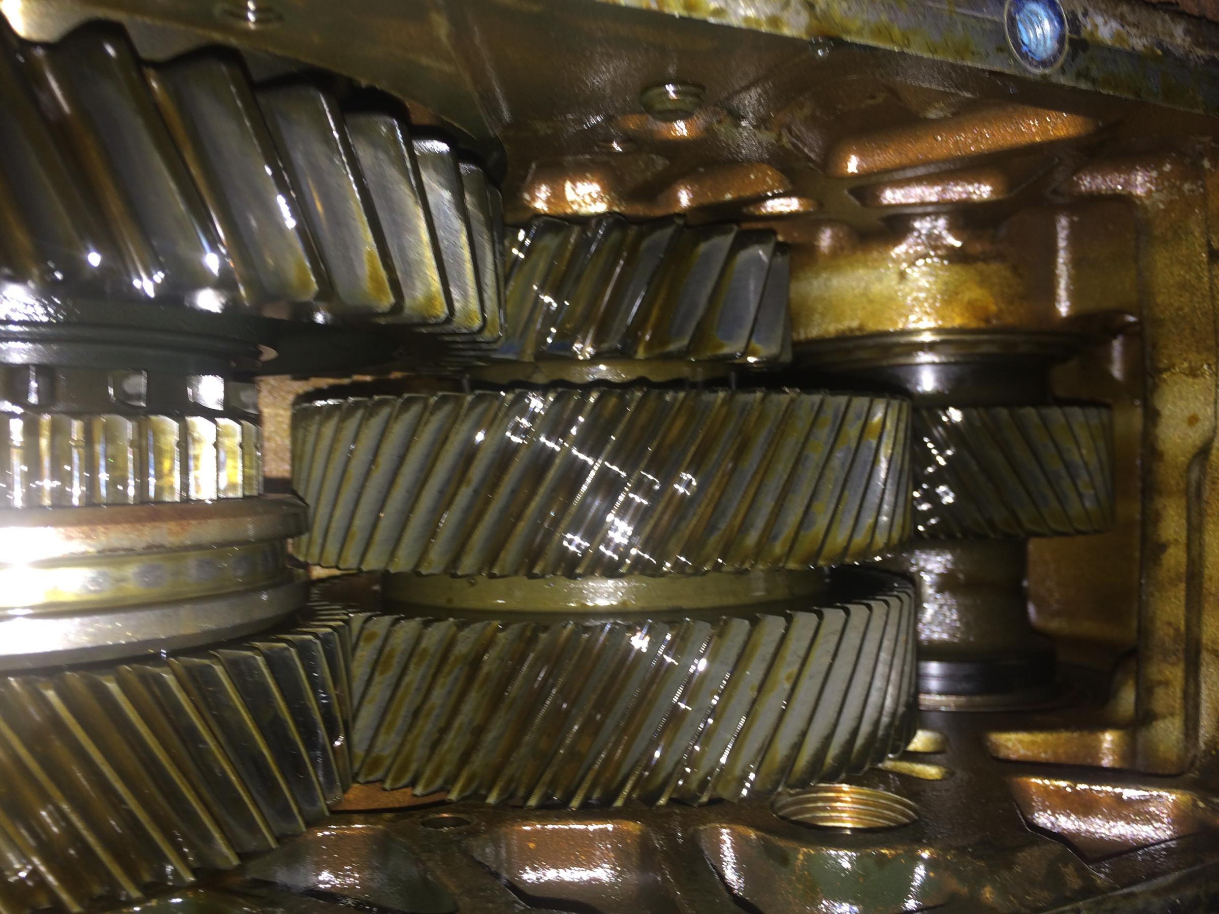

Tranny in n, t case locked. I'm spinning gears and all is smooth and looks good.
This is pointing back to the 3rd.
I think I should pull gaiter off the cv before I pull tt apart....thoughts?

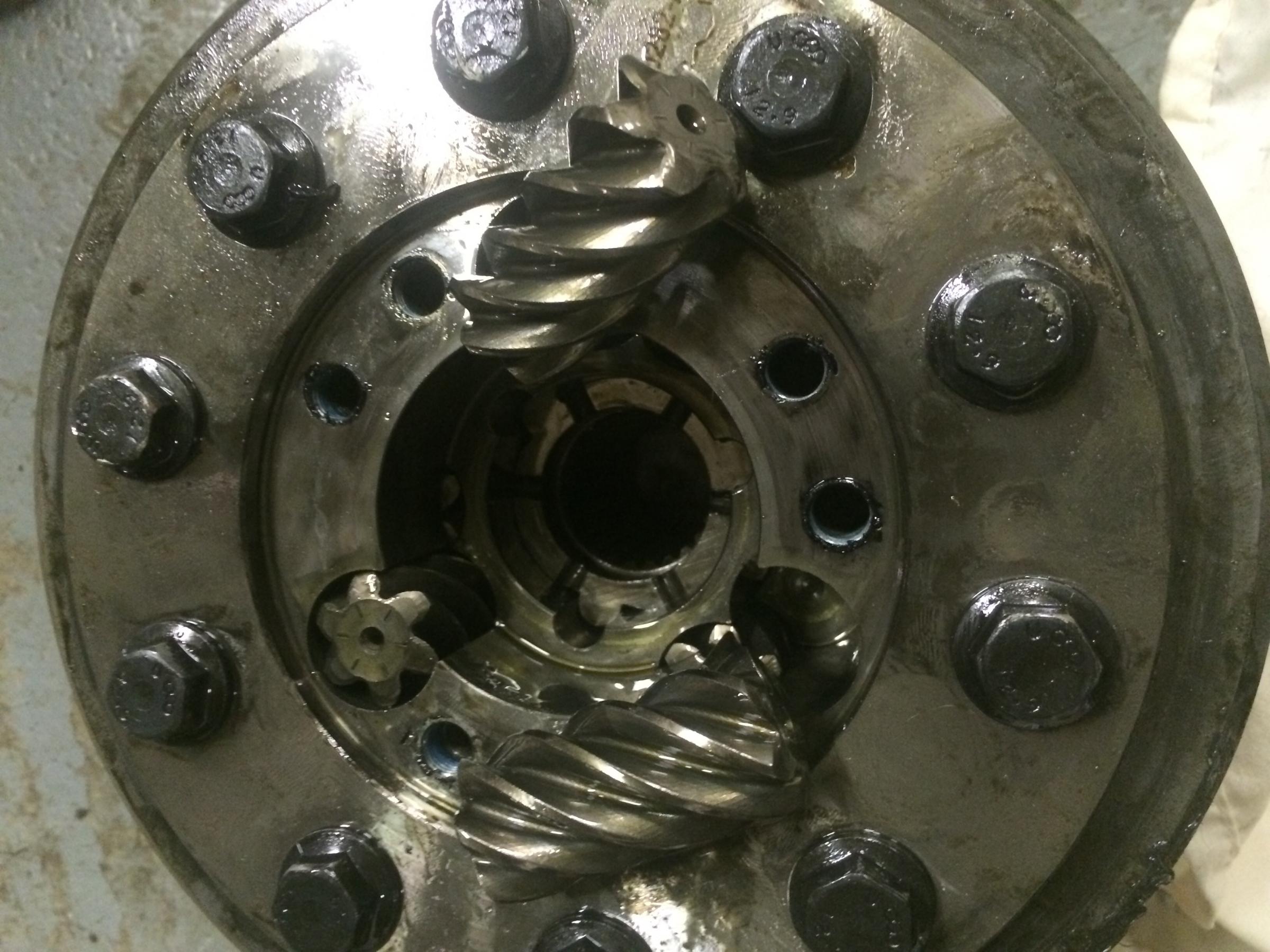

Well, tt apart all spirals look good no damaged teeth no damaged bearings.............what to look for now?

You would think you would feel a CV that was that bad, and not have to hunt for it.
