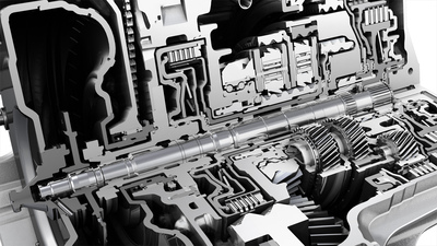

And your engine computer is programmed to talk with the tranny computer constantly. Swap to a six speed automatic would be complex for a DIY garage. Unless you are pals with Ironman Tony Stark. Then you could slide in a 9 speed from an Evoque....
Back to the real world, enjoy what you have, maintain it with open check book, think about CDL if you don't have the locking lever, and maybe after market lockers. But certainly an aftermarket shaft for that prone-to-snap front drive shaft.
