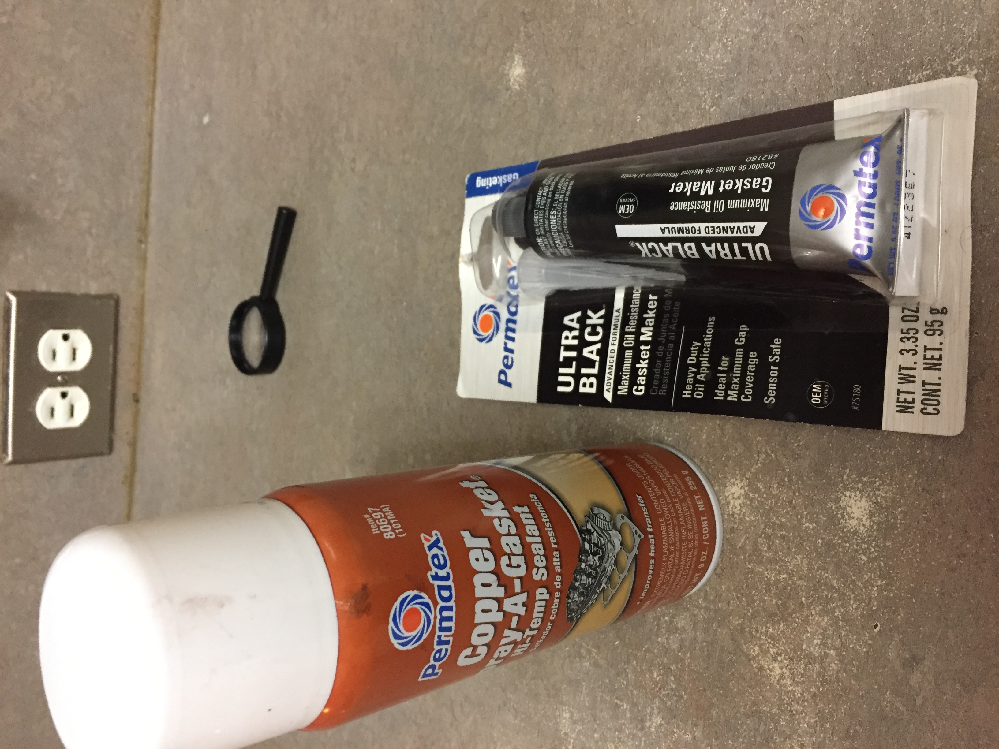

would any of you use additional Gasket materials (Silicon, Permatex copper, Black silicon etc) ?
I am tired of Valve cover gasket leaks. no amount of tightening helps. So I am doing this all over again .
would you use any additional materials on Upper intake Plenums gasket? Like Spray copper?

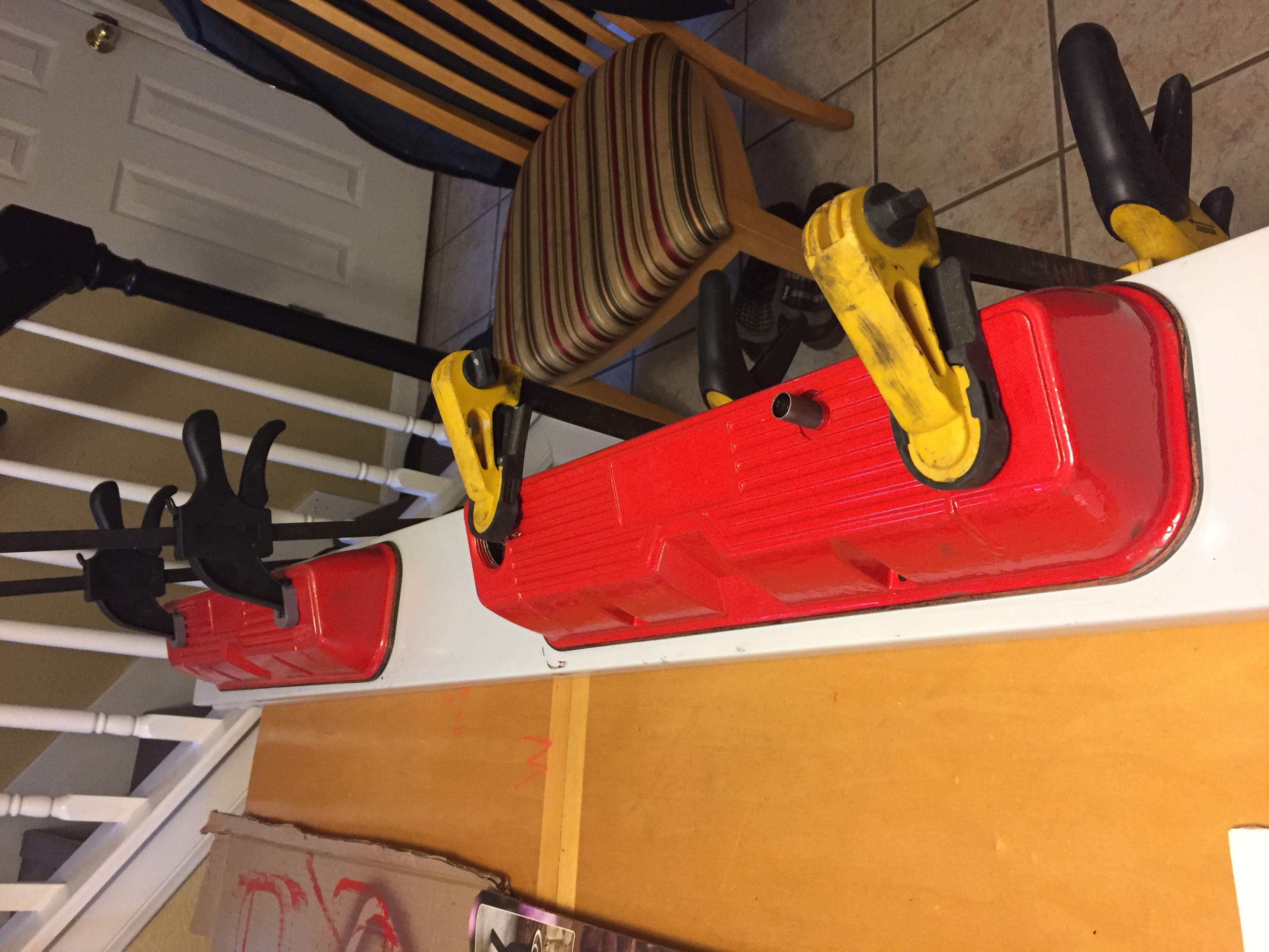

I have two on hand now (pic). I have used the copper stuff on the Cover and letting is dry overnight. I am planning on using the Permatex Ultra Black on the other side or the Copper spray?
any suggestions? or bad experiences?

Thanks Joe. I know you mentioned this other day. If you see the pic above That is exactly what i am a doing except I went step further to clamp just so there is no uneven areas.

I really like how you clamped that cover to the table; way better than my sitting it on the floor! Have you put the covers on yet? I have always done that manifold gasket dry, but I'm either going to double them up this time, or use copper on the upper manifold side/ dry on the lower manifold side. The face of my upper plenum is not perfectly flat and I'm concerned that it's not sealing completely. But that's just my situation. Would love to have dropped that off with my other parts at the cylinder shop but in my haste, I forgot to inquire about it.
