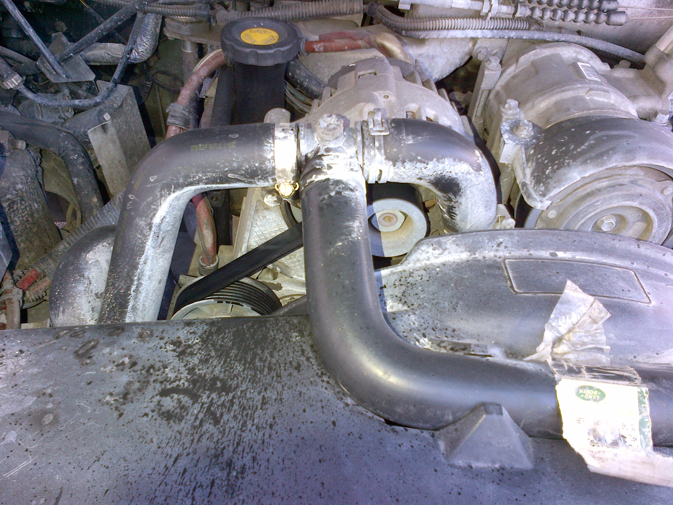

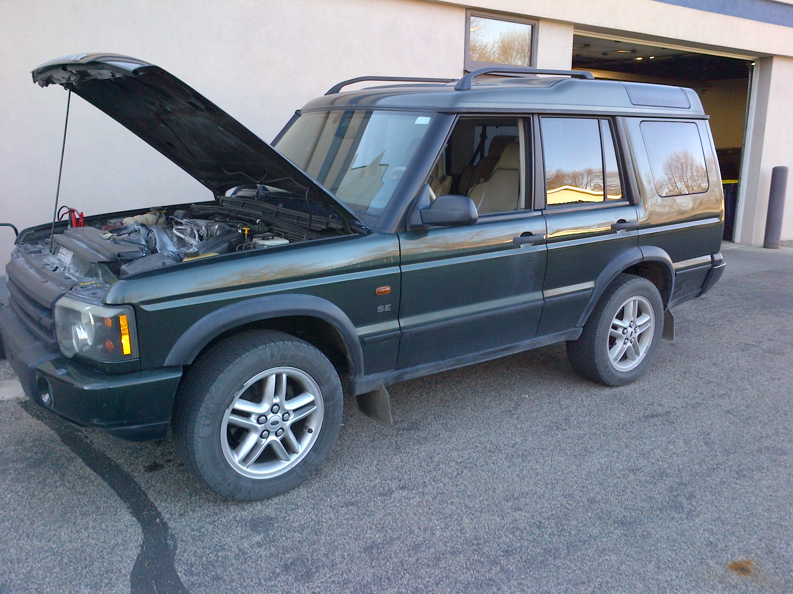

Well here she is- I charged the battery all day and took it for a spin. It actually started good and drives ok. The warning lights were not on now and the temp gauge sits right in the middle after warmed up. I pressure tested the cooling system, after 2 hours it dropped from 17 to 12 psi and found a leak coming from the radiator hoses where they join together in a tee. I'm wondering if it has been leaking there for a while- because that whole area has a white crust on the hoses. Looked around heads and didn't see any antifreeze leaks so that looks good. Still waiting to hear back from the body shop on windshield and back glass cost.
I like the way it drives- like a tank. Good visibility and decent seats. It's starting to grow on me. I have several vintage motorcycles that are just like this truck. They are quirky and require lots of fixing- but that's half the fun!
Thanks for the opinions and info fellas. Will let you know if I buy it.

If you read around you'll see three are lots of Disco2 specific things, like with most vehicles. One of them is that the top hose T piece is terrible.
You need to replace that and retest the coolant pressure.
