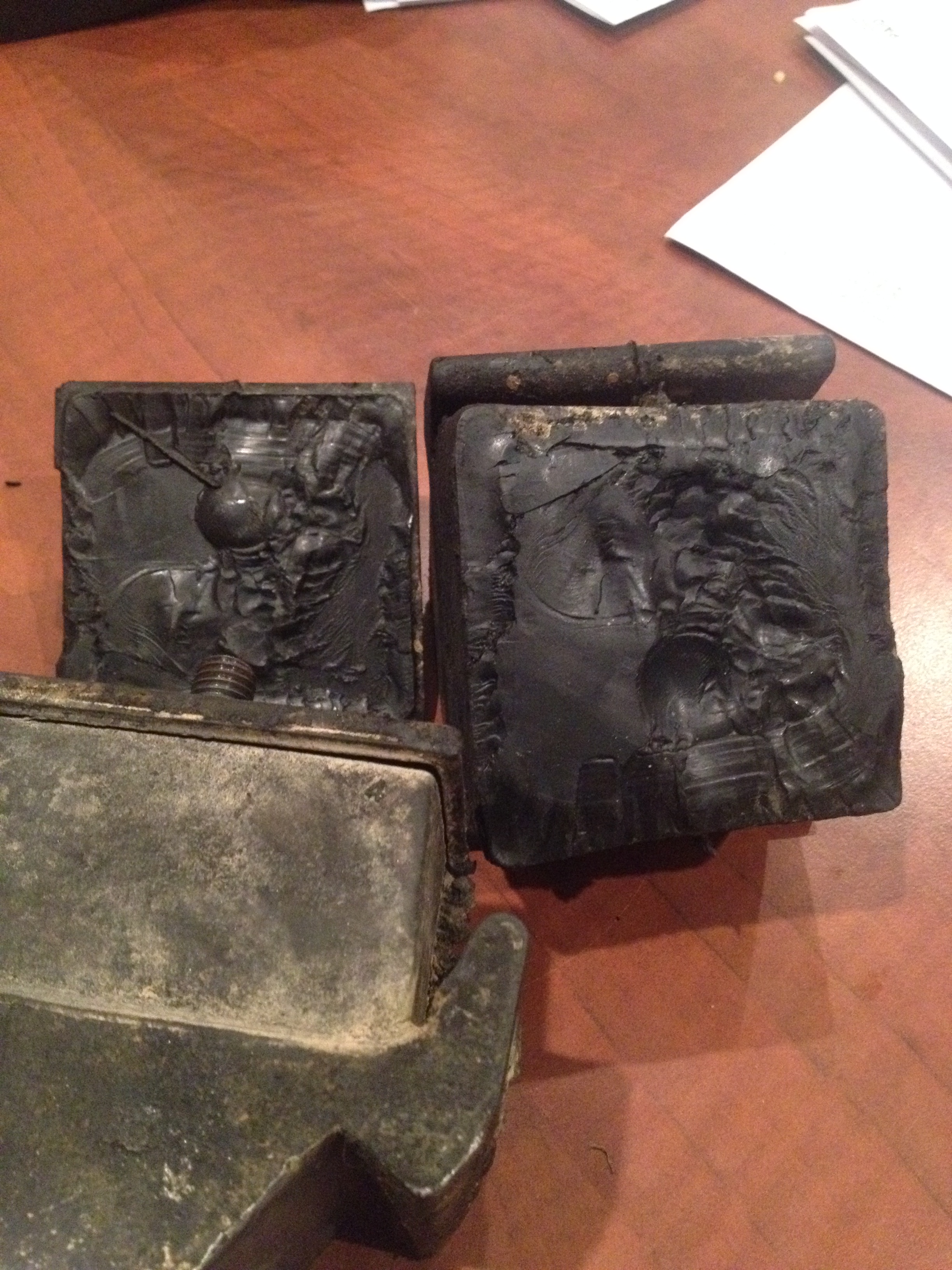

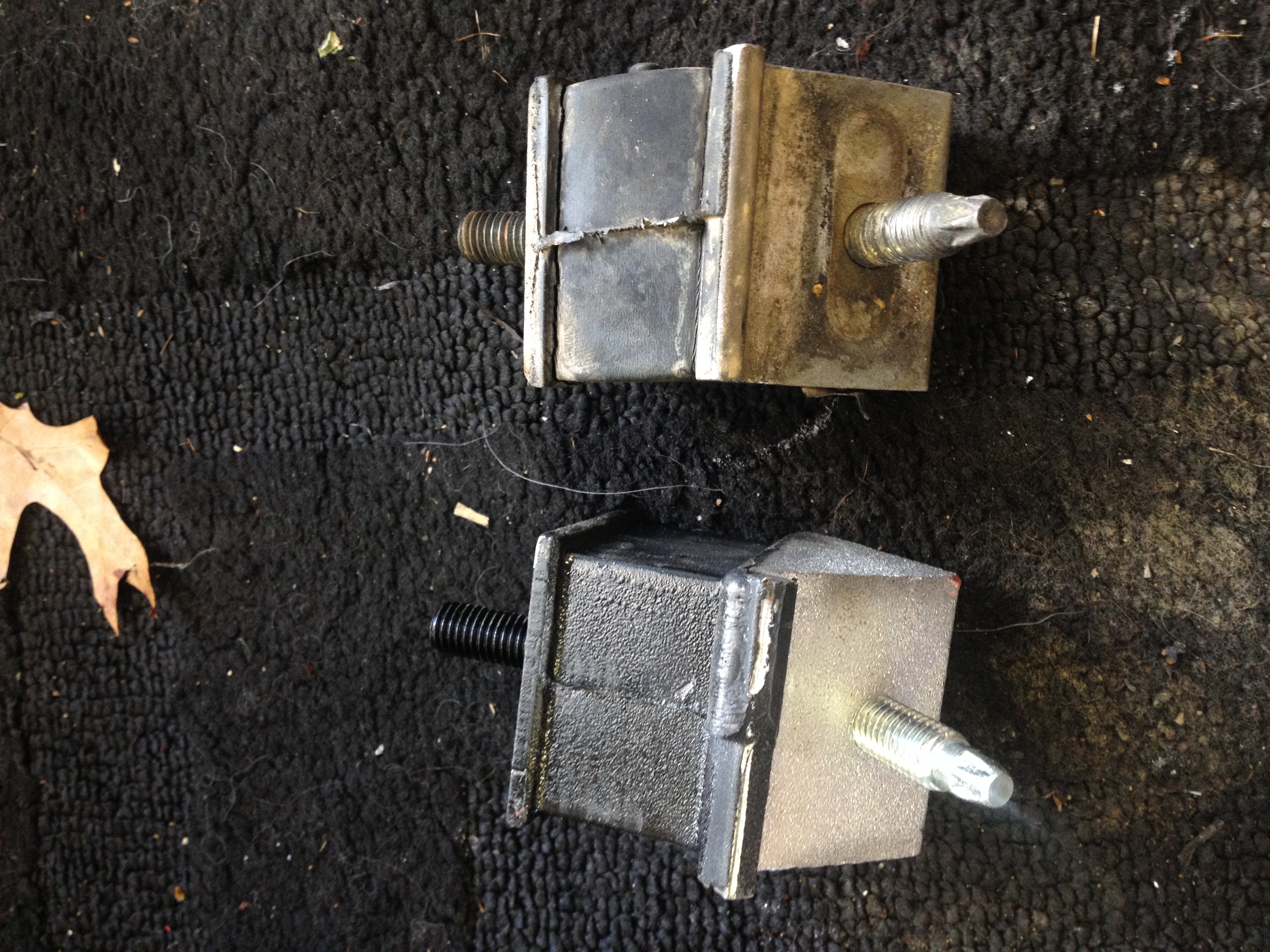

I think bushings/mounts are probably far overlooked on these vehicles, i own a few bmw's and at 60,000 miles most of them need replaced and it makes a world of difference. I may look at doing some of the other ones in the near future.
Front Driver completely destroyed. Front passenger you can see the gap from rubber to metal.

Rear transfer case side, split and twisted.

BTW, I think the engine/drivetrain mounts are an interesting idea for stopping the vibration. I certainly have known other vehicles to have crazy vibes due to engine mounts.

It's like the rear driveshaft rotoflex, you only realize how bad they are once you hear others ideas and experiences and then inspect your own. The ones in the photos are destroyed but it is unlikely you would know until you remove them. It's a worthwhile repair exercise I would guess. If nothing else, after 100K miles it cannot do any harm.

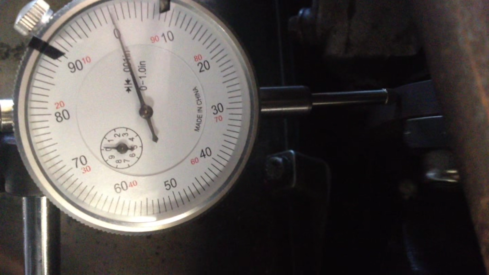

Checked the run out according to landrover tsb, on the parking brake drum, the tc output flange and front diff flange. All was under .10 which is within spec. Im starting to think front hubs/diff.
Hi what's 'tsb' and 'tc' ? 0.1 is huge, a tenth of an inch - do you mean 0.001 (one thousandth) or 0.010 (10 thousandths), I'm sure you mean the latter below 0.010 (10 thousandths)
I have to admit your mag block and dial gauge are the 'business', I use exactly the same type but made in the USA 40+ years ago
