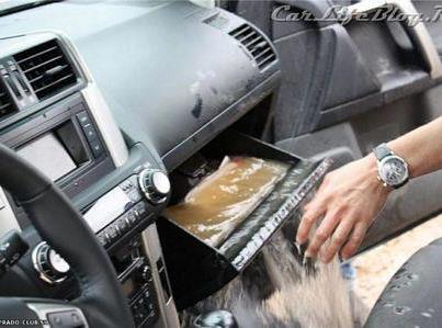

Likely time to change diff oils and transfer case oil. Depending on how high the water got and the level of your vent lines. Some vent lines are high inside the engine bay, some owners extend the others that are not. If you remove the banjo bolt from the axle you may find mud build up (rear ones). Also may have quite a bit of new mud and trash stuck to and between the radiator fins (AC condenser,oil cooler(s), and engine radiator).
Attached Thumbnails Wading removed my licence plate!-75159_441046305938000_1496014661_n.jpg
