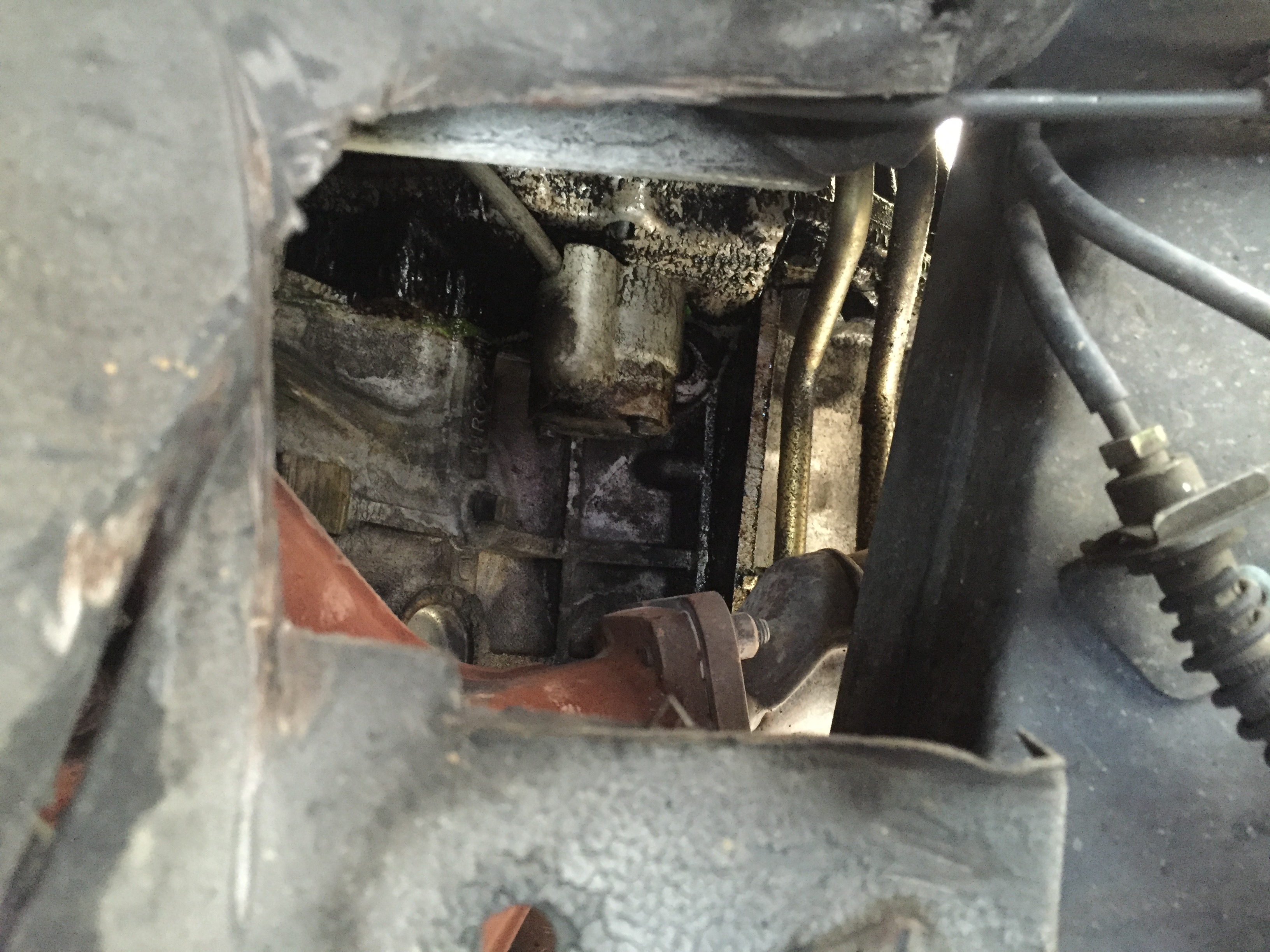

Do the attached pictures show the crank sensor? I remember the previous owner mentioning they replaced it (or something that sounds similar if I took the wrong pic), and they cut through the wheel well to access it.
Maybe all that oil dripping down had something to do with its failure?

Yup, thats the crank position sensor.

Yep, that's it. Jeez, what a destructive way to change it. I'd recommend after you've replaced it again you take some self drilling screws and sheet metal and cover that hole. Oil drip pans work well because they're galvanized and thin enough to cut easily. Like $11 for one at WalMart.

Originally Posted by robert.juric
...and they cut through the wheel well to access it.
ಠ_ಠ
The oil leak will definitely cause that sensor some grief.
