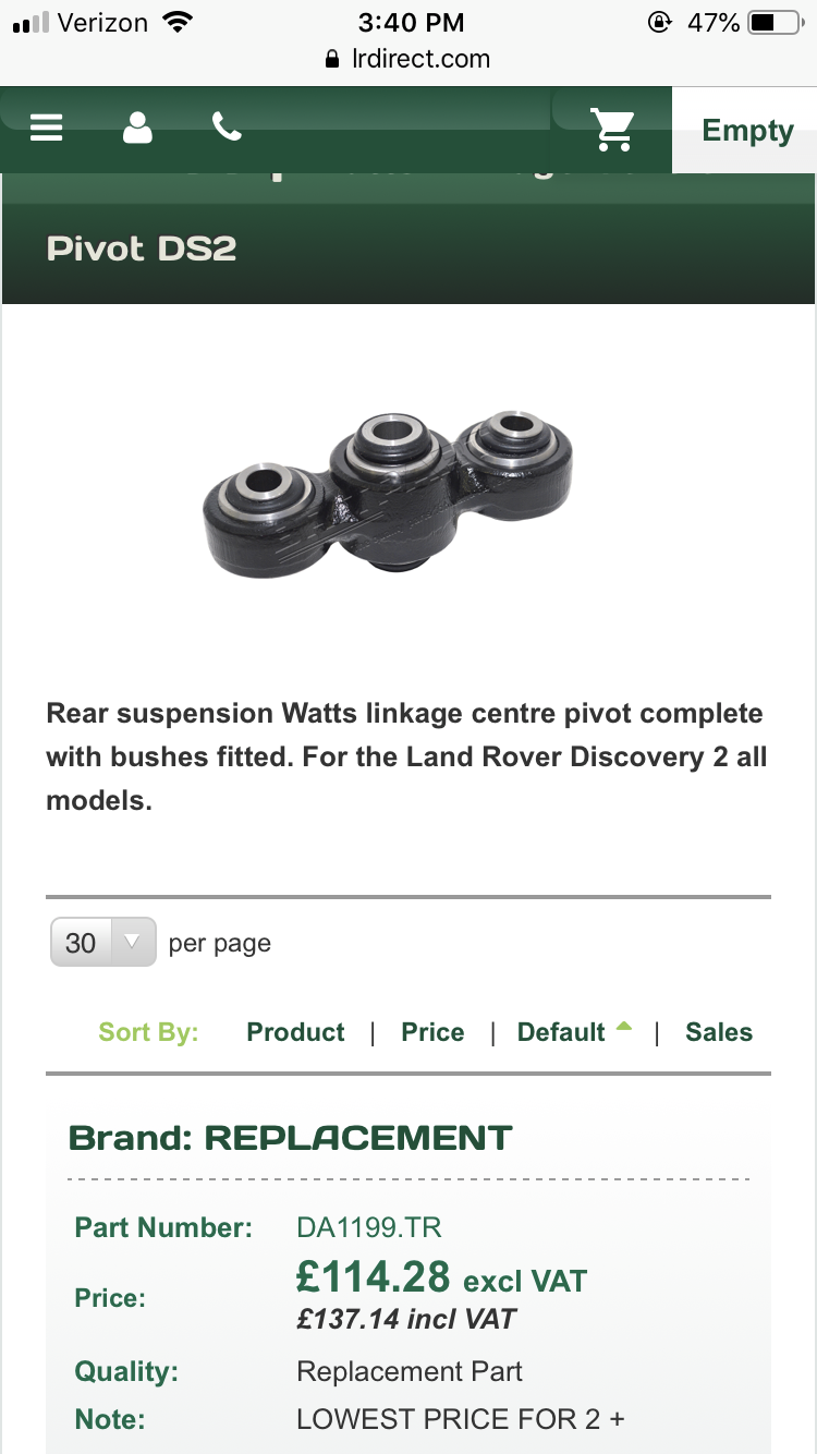

I ordered my watts linkage from LRdirect or Rimmer Brothers, can’t remember which. I saved $100 or so.
Old May 5, 2019 | 03:41 PM
Frank4's Avatar
Joined: Feb 2009
Posts: 1,200
Likes: 183
From: MEMPHIS, TN
Here you go:
This works out to be $149 USD
