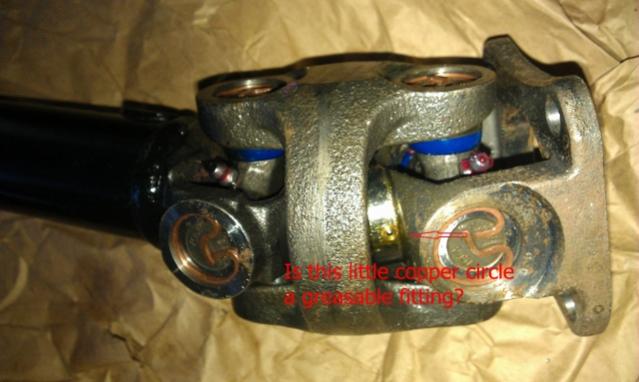

Mine chirped as well. However, I got the "doom-kauff" award because I didn't lube the front prop. That's where the chirping noise came from.
If you have an aftermarket front prop, should have 4 to 5 zerk joints, maybe even a "button" lube joint. Located in the cardon joints. See photo of what I am referring to for the "button" greaseable joint, as well as a couple of zerk joints.

I just lubed it the other day
