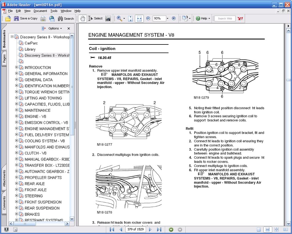

This appears to be the diagram for the coil....
Out of Rave manual..
Dont take this as gospel.. but here it is anyway...

i was looking at that on my rave as you posted,,,

I believe the pic from the RAVE is if you are standing at the rear of the truck looking forward. So you need to reverse it if you're looking at it from the front end of the truck. Very stupid.
