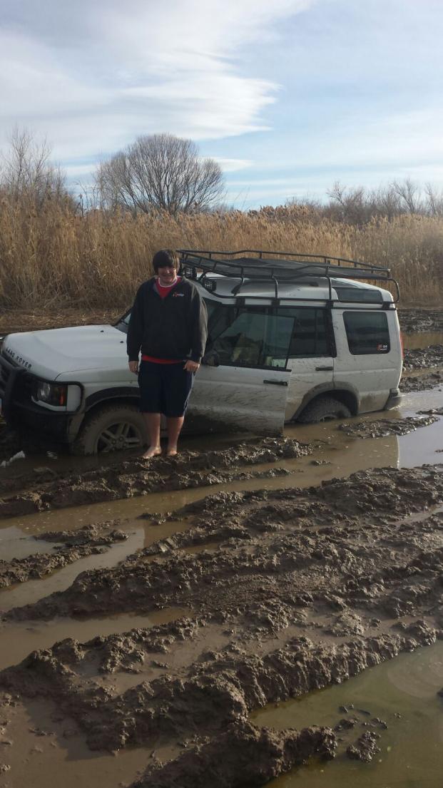

I went Mudding in my 2003 Discovery II, after some fun in the mud i got stuck. I was actually stuck in the mud for a couple of hours. My Traction Control did not work great so i was stuck just spinning one tire. if you need to know how deep i was i can post a picture of how deep it was.

Thank you all for the feedback!! I am also pretty new to these forums so i did not know how to upload a photo, lol but now i should be able too, I have also just recently fully got the 3 amigos, i have had the TC, ABS, and the emergency brake lights turn on before i went mudding. Now i have the TC, ABS, HDC and the emergency brake lights on. I am pretty sure the sounds and vibration is just mud but i really want to make sure. I have not checked the codes yet since we have loaned our Code Reader to a friend so i will not have it for awhile, and i have not been to any other place that reads them lately so ya. It was sad that the mud was not that deep on the right side but the left rear tire was the worst and the TC could not control it so it just kept spinning.
Attached Thumbnails Went mudding, i now have some new issues with my Discovery II-cole-stuck-mud-1.jpg

Sweet! Maybe not really deep, but definitely deep enough... And it looks nice and sticky/suctiony.
