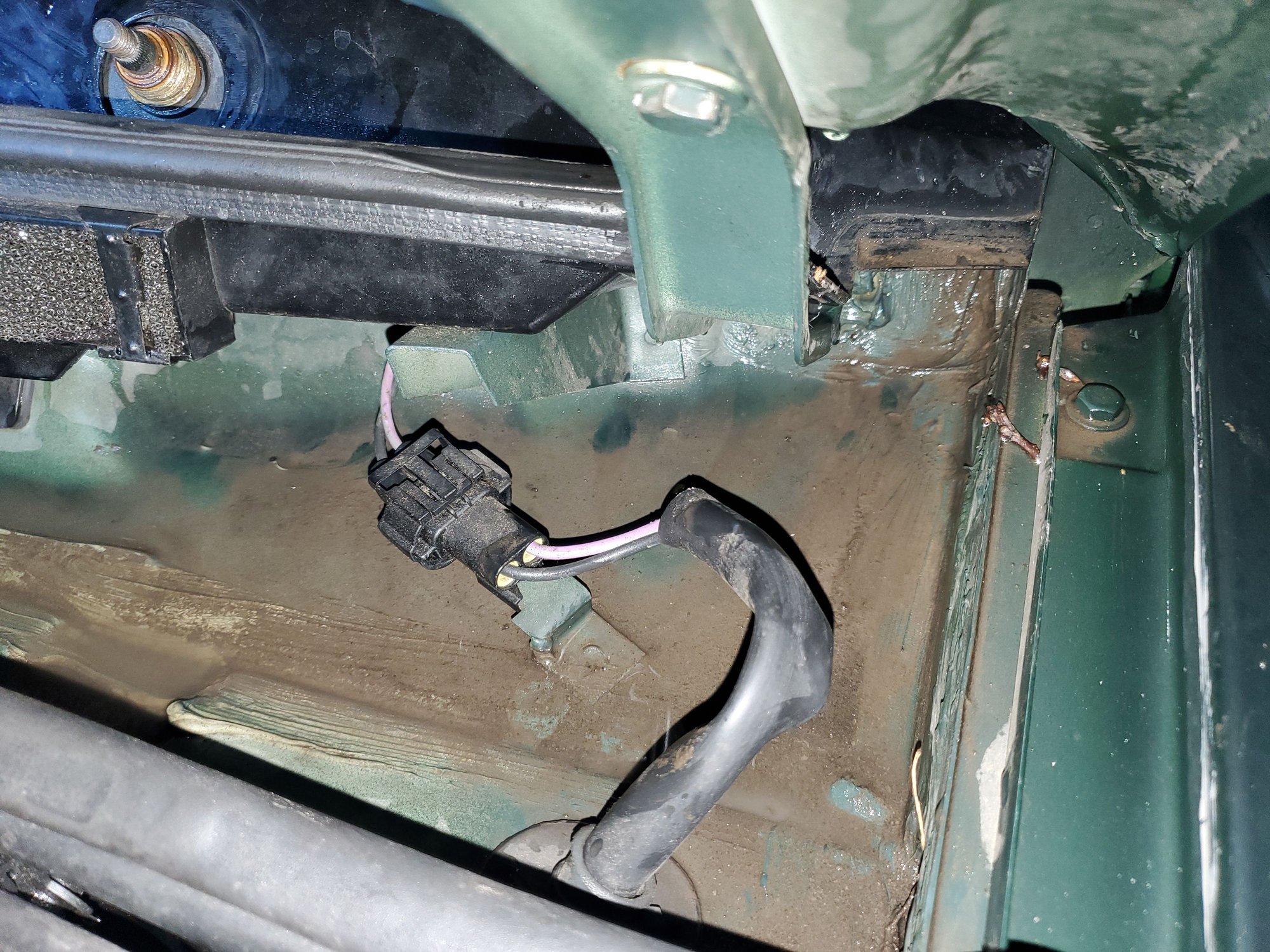

I get some pretty water on the floor after rain. I took the whole front apart, the cowl, A pillar, door gasket, etc. I poured hot water down the roof to see if I could find where it may be entering. Nothing obvious at the floor, water was still cold.
The first picture, is about where the water appears to enter the interior. Above that level is is dry.

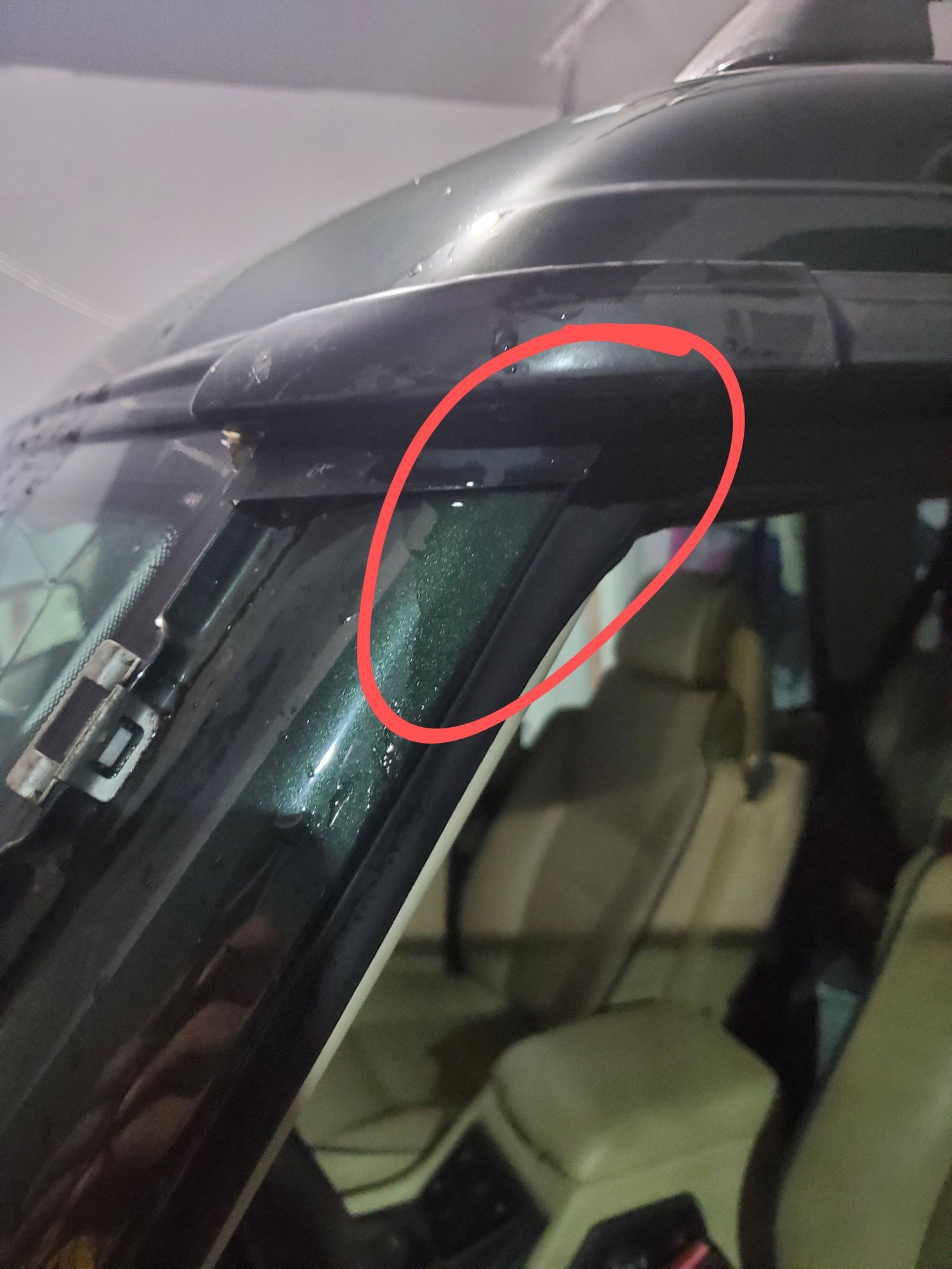

the second shows where water flows behind the gutter piece. Should this be water proof? I think that i will seal that up, to force the water towards the windshield. When water does run behind the gutters there is flows down the a pillar pretty directly into the interior.

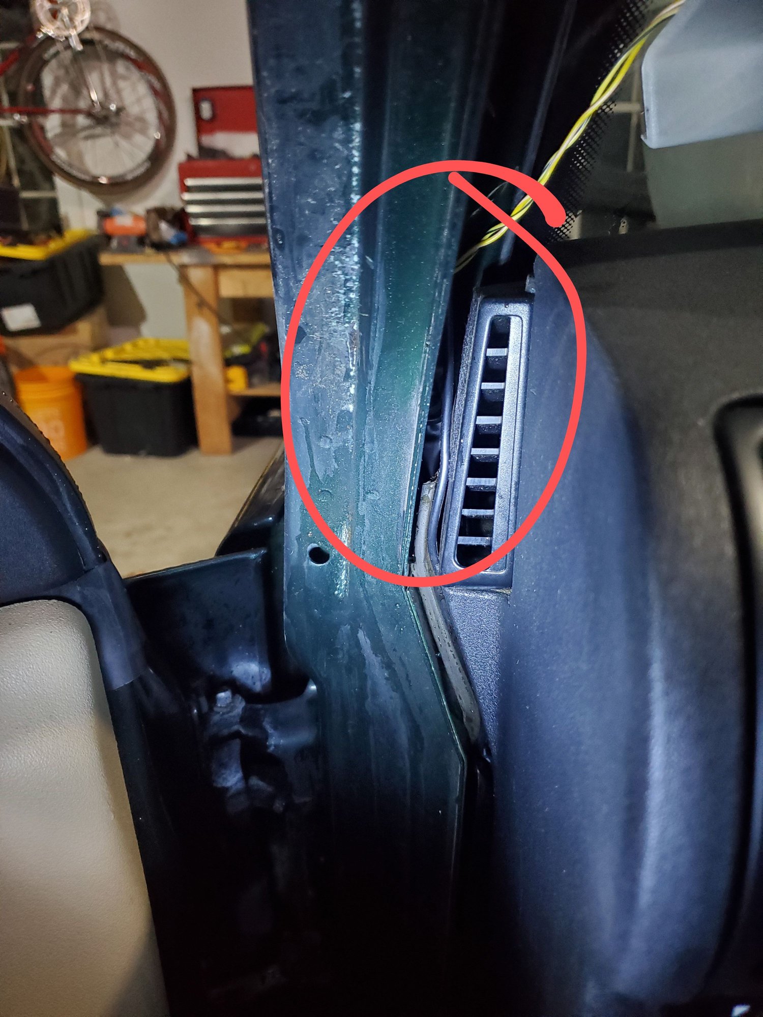

The thiRd picture, that area drains properly. Also, the air intake is dry, no leaks into the dash from the area of the blower motor.
Anywhere else to look before i put it all back toghter?
