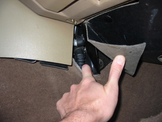

You are good enough on the carpet, that is what I was talking about. Just so you can get air under the carpet. This is where mt drains connect inside. A D2 may differ slightly, but same basic idea.
If you have not had any rain, it is either coolant (sweet smell) or those drains (there are 2).

Thanks. I'm going to have a go at the drains again to be sure.
