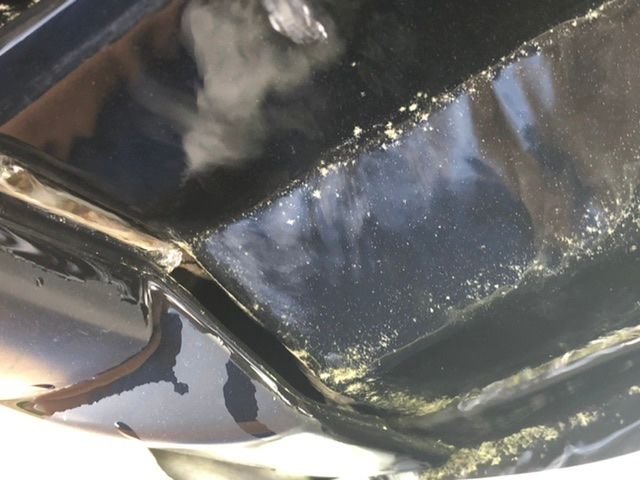

Gap at bottom of A pillar
Seems to be leaking from the inside out as it is dry above that line.
Well I ran some water on top of it today and narrowed some things down but still can’t pinpoint the leak.
I pulled out the passenger kick panel, no water is running down the inside of the A pillar or on that side panel. When I put the key in and the AC blower started going I noticed water dripping right down from that area. I found a gap at the bottom of the exterior A pillar, but it looks so large I’m not sure if that’s the source.
