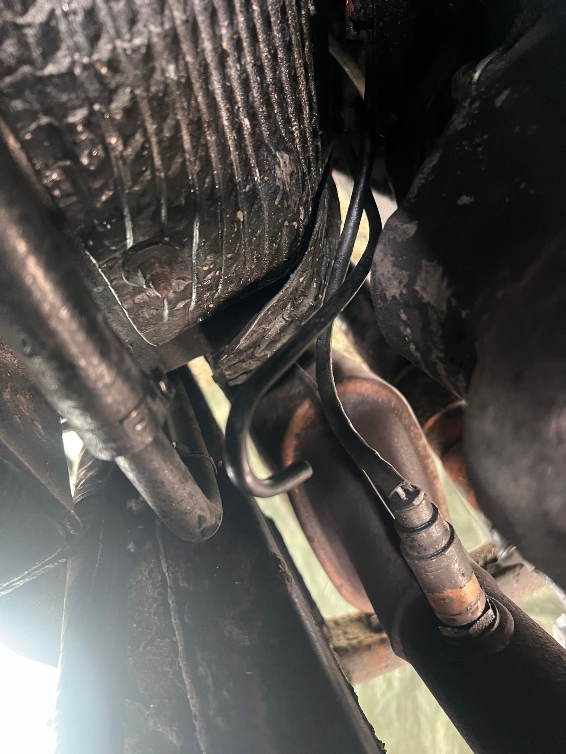

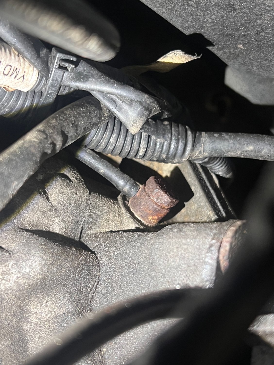

Hard plastic line that seems to end with a banjo bolt on top of the transfer case, doesn’t go anywhere at the front end. Is it a breather that’s come unattached from a clip?
Seems similar to vacuum line up top, but is a smaller diameter.
The banjo bolt seems like a big deal just for a breather.

Yes it's a breather.

Breather for TC & Transmission run together and usually sit via a bracket behind bank 1 valve cover.

Great. That makes sense now, also found a 2nd one that was looped in an odd way.
When I get back under, I’ll see about running them where they should go.
thanks.

The loop is to prevent water from entering the breather. It should be mounted so the top of the loop is pointed to the sky, and the opening should be facing towards the ground. Check the other breathers as sometimes they fall out of place and melt on the exhaust. If this happens the TC and axles will over pressurize and you will notice small leaks out of the weakest seals. It's not fun trying to chase down all the leaks only to realize your breather is melted onto the exhaust or the vents are blocked.
