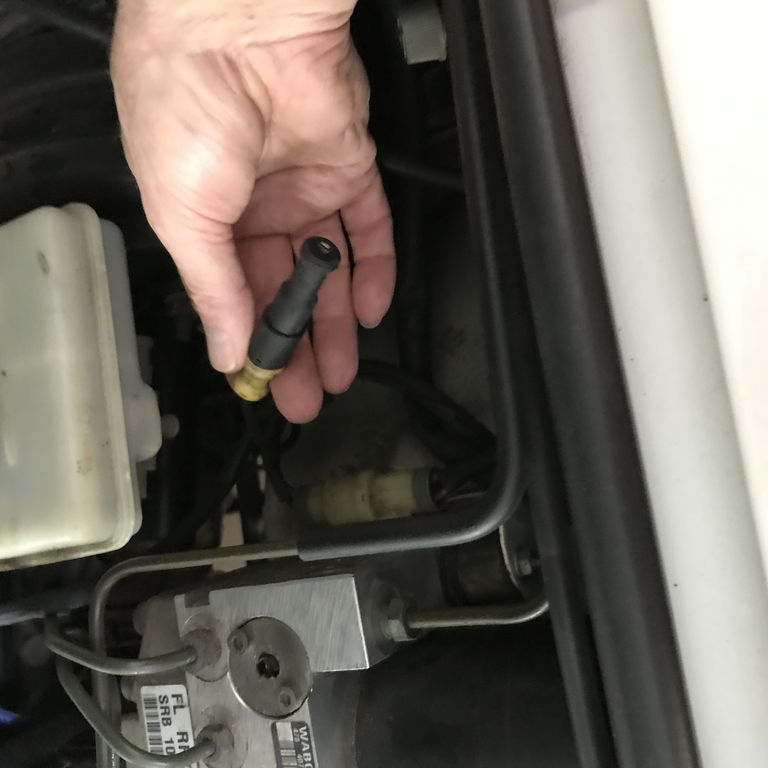

Need help to identify a wire found loose this morning. It's just behind the ABS unit and was discovered as I was working on the shuttle valve switch and appears to have been cut at the smaller end.
Any help in identification will be appreciated.

That is the ABS Sensor Connector.

That's where the FL ABS sensor plugs into the rest of the harness. If you are trying to run down an ABS light on the dash, this is your problem (or at least part of it).

Three amigos were cured with replacement of the shuttle valve switch, so no dash lights are showing and no faults recorded.

When dealerships replaced the abs sensors with the new units, they hard wired them directly to the computer and left the old lines with the connector in place. So that's just an open ended wire that terminates under the dash somewhere.
​​​​​​save the wire and connecter and you can splice it in if you ever want to use a sensor with a factory style connector again in the future.
