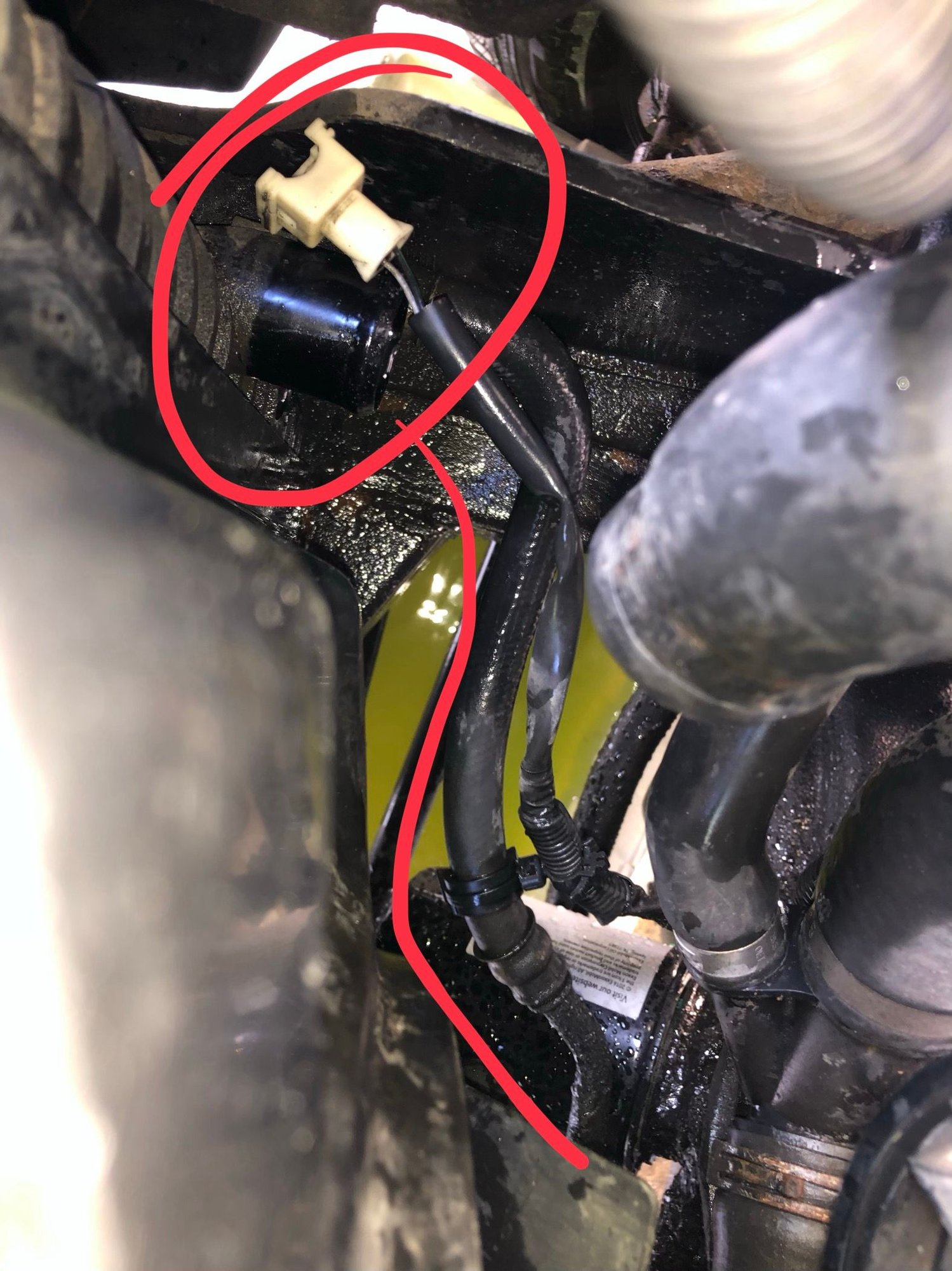

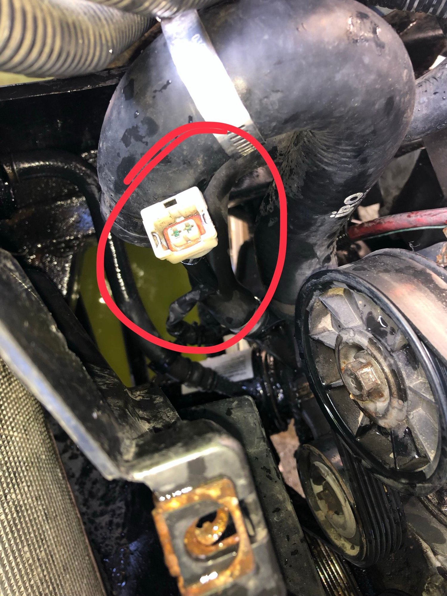

Flushing the cooling system and changing the tstat and saw this just hanging loose. What is it?

The plug for the temp sensor on the bottom of the radiator? Passenger side bottom facing the firewall.

With that unplugged you’ll usually get a P0126 fault.

I'll check this evening to see if I have the sensor... if not, it just hangs there? would some radiators have the sensor option?

SAI = additional temp sensor on the radiator. Non SAI = no additional temp sensor. I’ve worked on plenty of D2’s where they have the opposite setup for their needs due to a previous owner or getting a used part from the wrong model vs how their D2 is equipped. Also a lot of new radiators have the hole but you either leave it plugged or install the temp sensor.

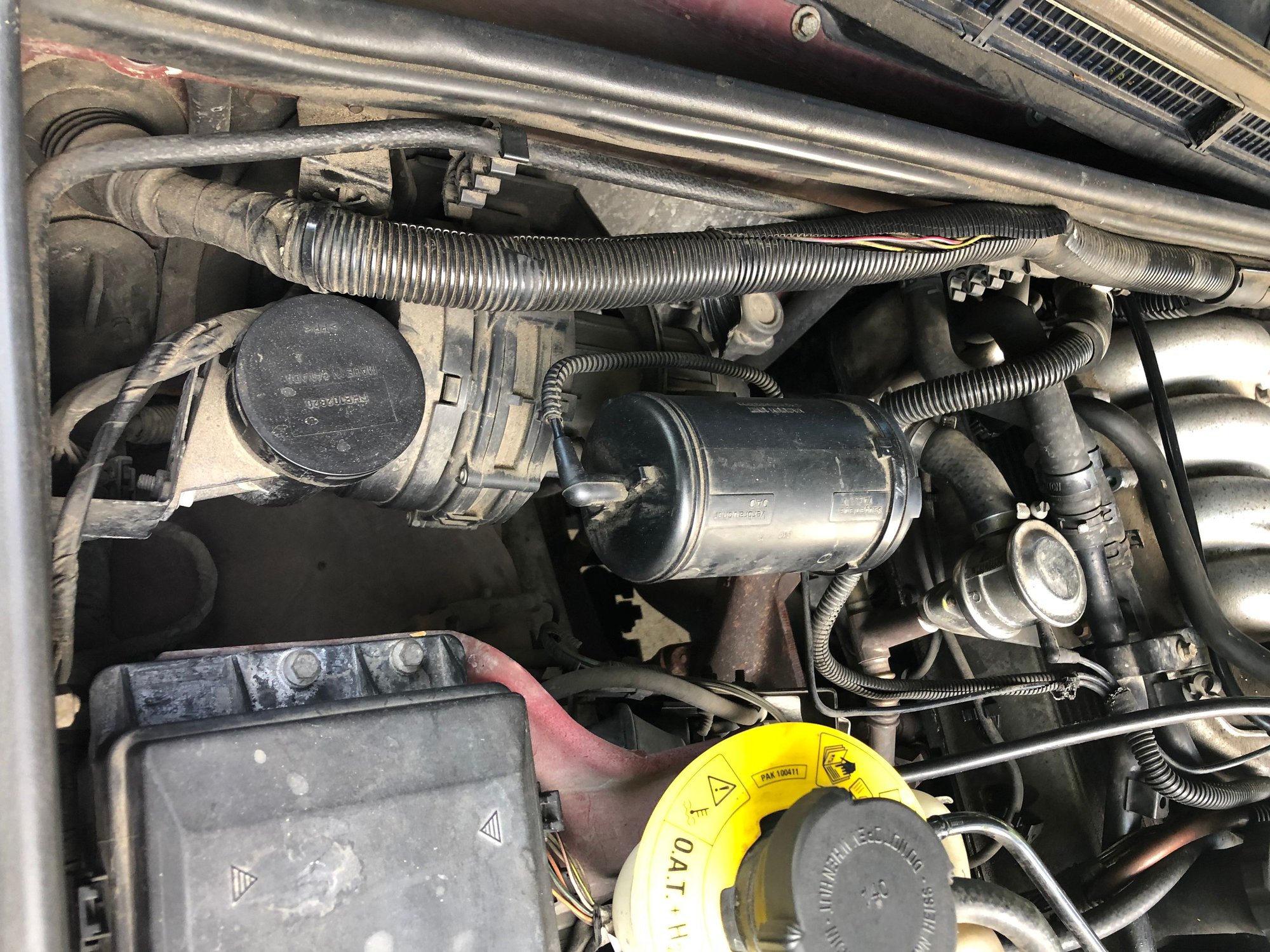

So looks like SAI... right?
SAI right? But don’t see a temp sensor on the radiator.
