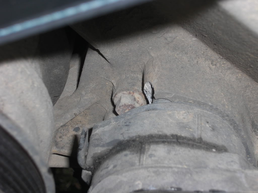

so while changin my serp belt i noticed that something appears to be broken on or very near the tensioner pulley... can anyone enlighten me as to what i have broken here...Name:  CIMG0920.jpg

DOH!!
Buy some JB Weld and fill it in, that is your front cover, expensive to replace.
http://www.roverparts.com/Parts/ERR6814G.cfm
http://www.roverparts.com/Parts/ERR6815.cfm

aww poo... it hasnt been leakin or anything i think the part that broke was mostly cosmetic...

It looks to me like the hole that your dowel pin on your belt tensioner sits in.
Your tensioner bolts to the front cover and then the pin keeps it from rotating while under load, rather than two bolts to hold it in place kinda thing.
Like I said, JB Weld it and call it good.
There shouldnt be anything behind it that could leak...if you look close at the new one on AB you can see where the belt tensioner goes and that hole that has been modified on yours.
Probally got smacked with a hammer or something. Aluminum is strong but brittle.

yeah thats what it is... i just wasnt sure if i was missing more than just a little bit... i thought maybe there was something more important there that i should know about... but thats cool... i was gonna change my starter today but i dont even feel like attempting that today... i looked at it and was immediately frustrated from the appearance of it..
