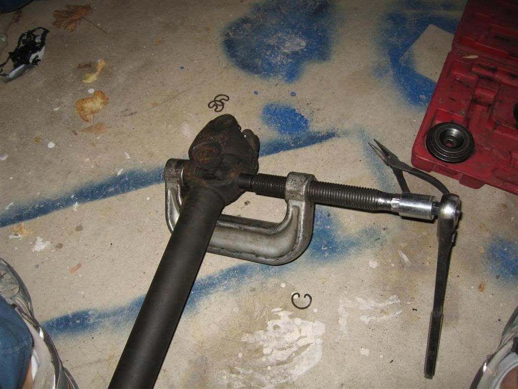

Alright so how to I use a ball joint press to install the u-joint? Is the goal to compress both ends of the u-joint at the same time with the press?

You push the joint all the way to one side then the cap should come off...turn it around and do the other side and you'll have the joint out.

In the driveline business, we use horseshoe shaped tools to press on the two exposed u-joint journal ends to avoid shoving one of the journal caps through to the inside of the yoke. If you have a welder and some square bar stock on hand, you can make one in a jiff. Either way, the aforementioned method will work, just be sure that when you're pushing the second journal cap through the hole that it is straight. Sometimes the cap will catch on the wall of the yoke and gouge it a good bit if it's not straight on the way out. Hope this helps!
