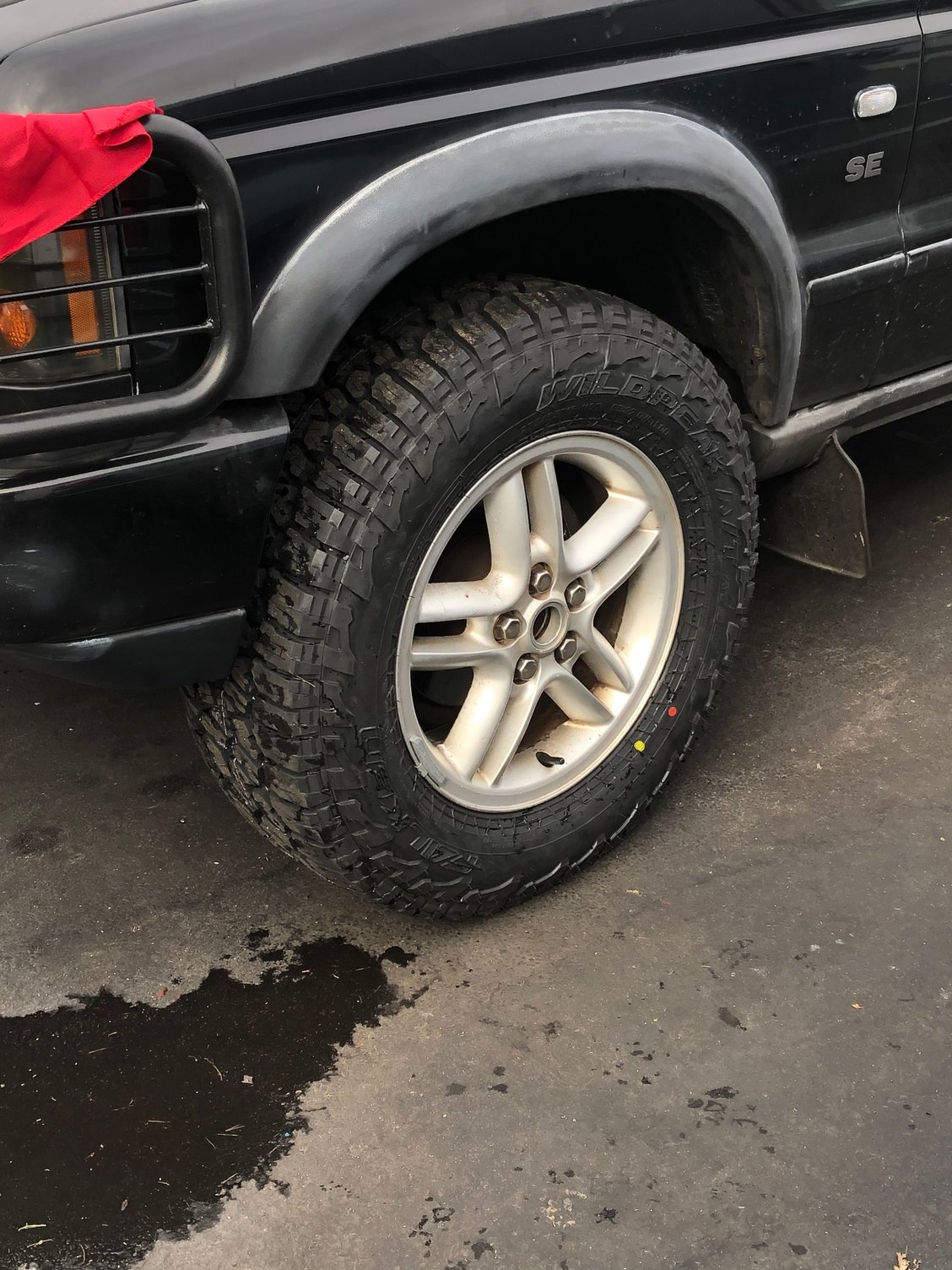

I am going with 275/65 r18 with a two inch lift.
test fitted so far and no rubbing in front.

I’m running 275/65/18 on 2” lift and only rub a little at full lock. Feel like it’s a good size for size of truck.
