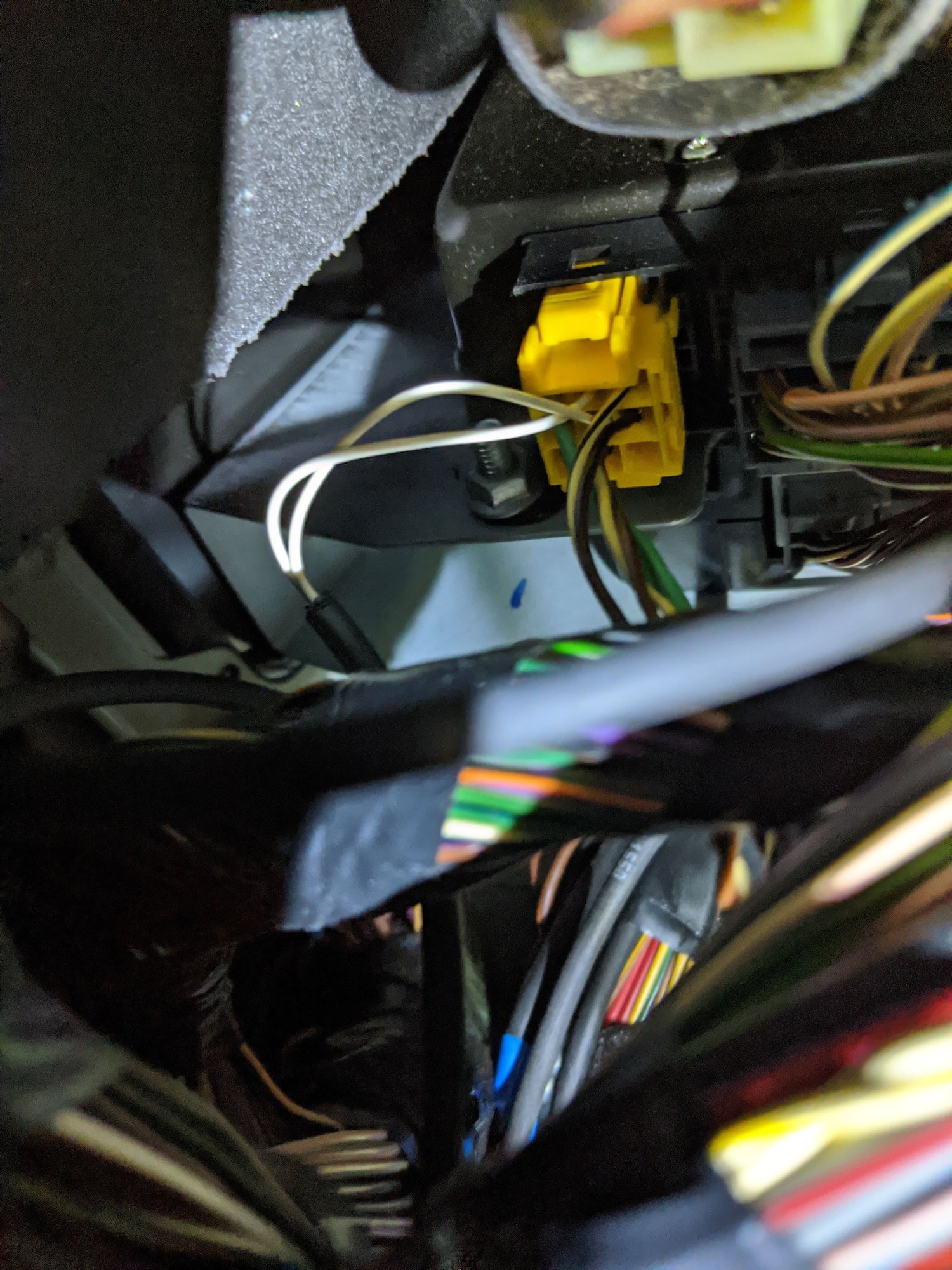

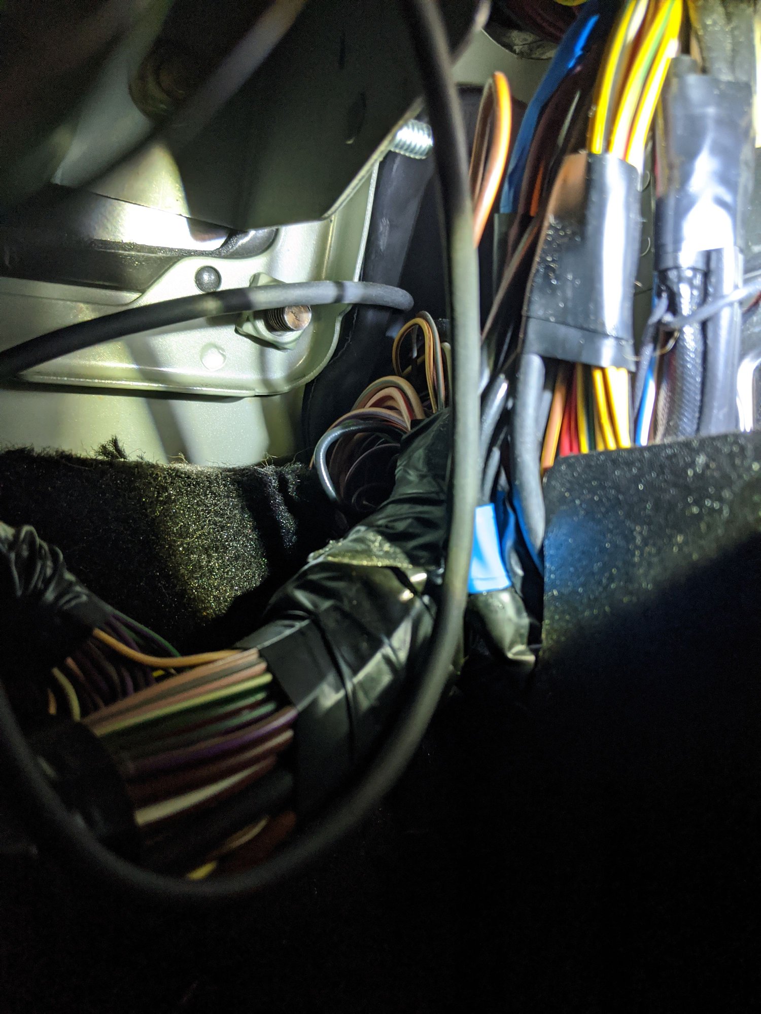

Old May 6, 2020 | 06:23 PM
Best4x4's Avatar
Posts: 7,997
Likes: 2,506
From: Beaumont, TX
In the very first pic I can see the new ABS sensor wire (black with white writing on it). Then in another pic I see it going thru the rubber boot into the cabin. To verify all you have to do is lower the black kick panel below the HVAC blower. then look up at the SLABS unit. You will most certainly see that same black wire with writing on it spliced into the connectors going into the SLABS Unit. With the Shuttle Valve switch fault I'd perform Option B, and inspect the shuttle valve wiring if it's all cracked. A new Shuttle Valve switch assembly can normally be found for 50.00. Then slap on Option B repair that should solve that issue for good. Sensor wise you could check the sensor itself. Some people have reported issues with some aftermarket sensors and it could have contacted the reluctor ring. To gain access to that sensor you need to remove the rotor.

Right wheel speed sensor cable coming thru the firewall.
Wires into the slabs
Pulled the tire and traced the sensor back to the slabs under the driver side dash. So I guess I need to replace this since I'm getting the error code.
Do I need to pull the hub off to replace the sensor?
