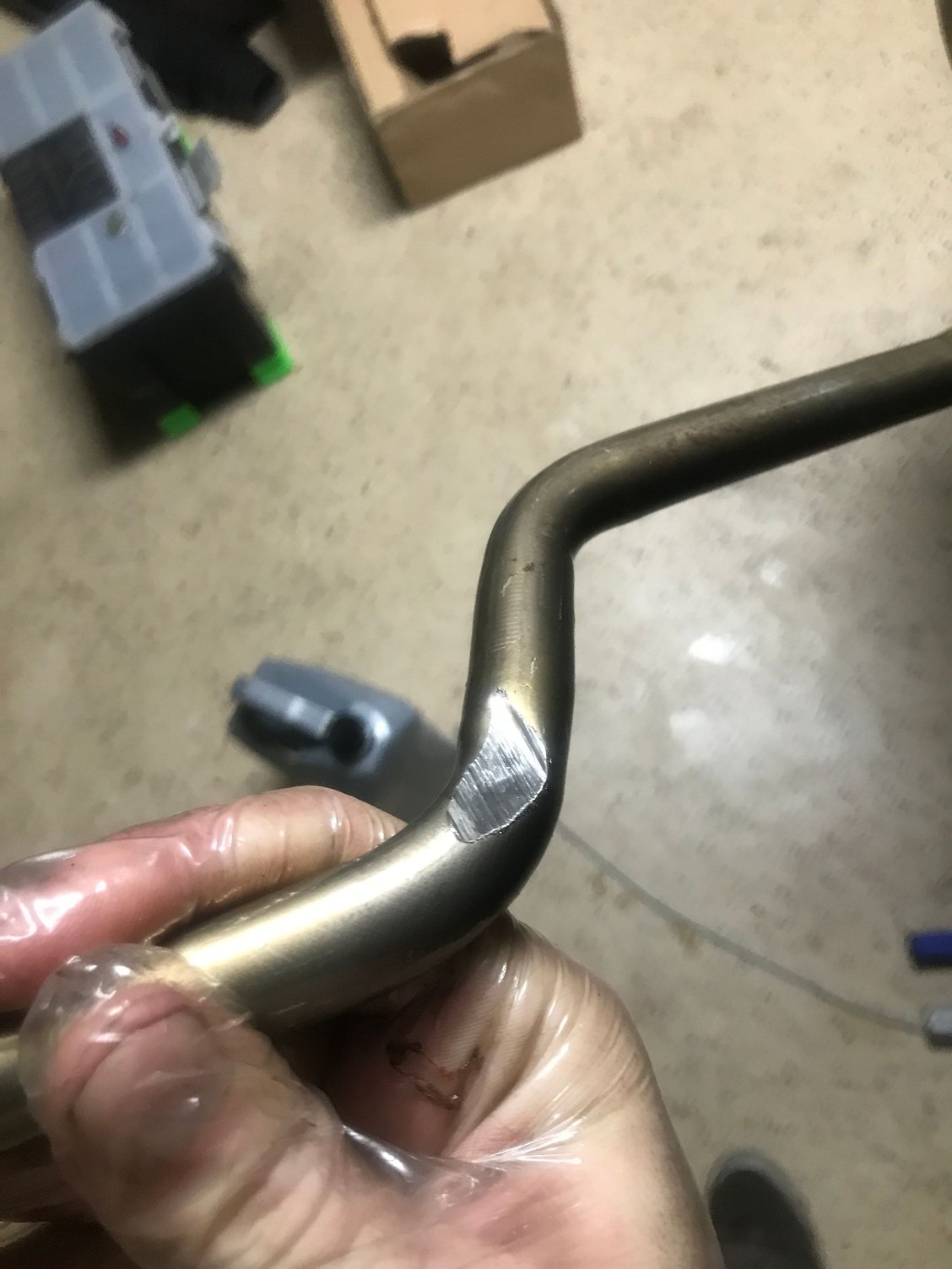

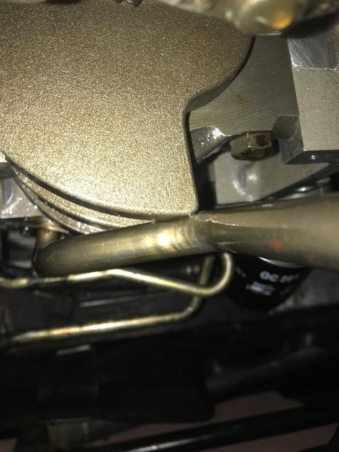

Converted my engine from a 4.0 to a 4.6. Saw a massive oil leak out the back of the engine. I didn’t properly seat the cam plug and hoped RTV would hold it enough. Dumb me. Also heard a tapping on the bottom of the engine which I feared I messed up a rod bearing. Then I saw this: the crankshaft was contacting the oil pickup tube. I’m hoping this was the source of the tapping.
See the gouging where the crankshaft made contact

yikes, did you forget to reinstall the spacer on the pickup tube or was it bent?

The spacer was placed in there. But I noticed that the nut holding the pickup tube was brand new with the washer being in the wrong spot. I definitely had another nut there. I found the original one in the bottom of the oil pan...so the shop I had it at to ensure proper oil pressure on the initial start up messed it up. I’m gonna have to go talk to them.

A good practice to follow, while assembling engine is...rotate crank after every process.
Install main bearings and crank, rotate, install cam/timing chain/gears, rotate, install pistons and rod bearings, rotate after each one, install heads and rocker arms, rotate, install oil pump, rotate, install pickup tube and pan, rotate, etc. If you do this, you'll find any issues as soon as they develop. Instead of getting to the end (engine in vehicle)...and finding an issue and not being certain what is causing it. When you do it in steps, you'll be sure to find issues immediately.
