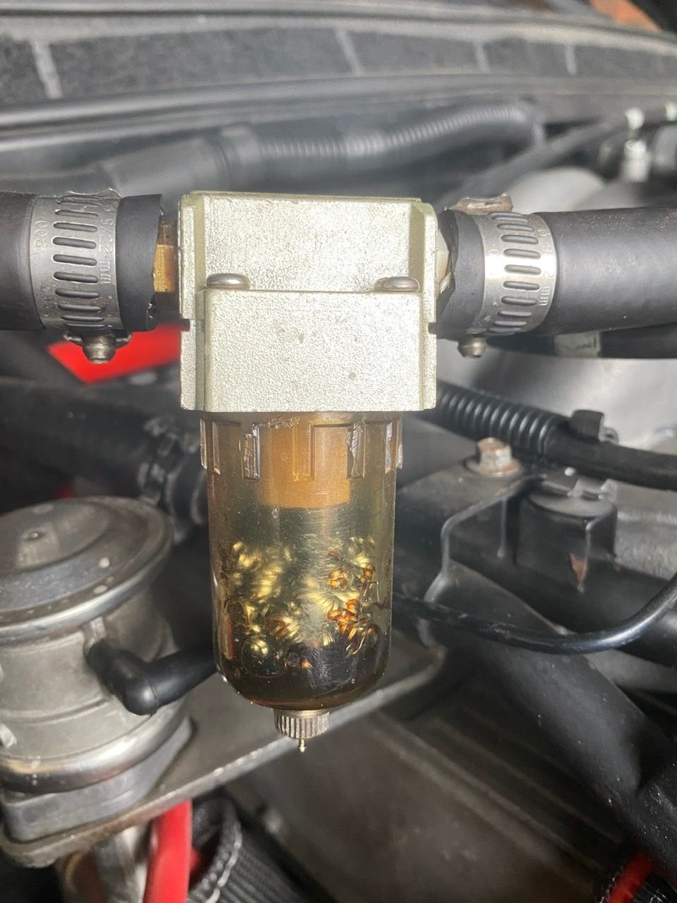

I haven’t driven it much last month so today I checked all the fluid levels. I saw I needed to drain the cr@p from my rudimentary oil catch container doohickey.
How often do you have to empty that? I always wanted to install one, haven't gotten around to it. Seems like it would make for a cleaner burn.
