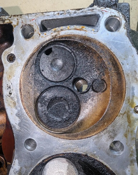

I just wanted to put an end cap on this thread with some of my observations as I took apart, cleaned, and put everything back together.
This took me the better part of 6 weeks as I only ever had 2-3 hours at a time to work on it, mostly just on Saturdays, and I work very slowly to make sure I don't screw anything up. Thankfully I do not need the truck other than for fun. I think realistically, if I had 6-8 hours a day I could have done this over 3-4 days.
The work itself was not too difficult. I have a large 1 meter 3/4" breaker bar that took care of the head bolts with relative ease. The biggest trouble I ran into was the d post on the alternator broke off when I was trying to loosen the nut. This turned out to be a positive as the new alternator is charging the battery better than the old one.
Upon taking the heads off, I didn't see a clear blow in the gasket, nor were there any "steamed cylinders." I did see a small area near the water jacket in the front driver side that could have been comprimised, but it was unclear.
Cleaning took me forever. The engine was covered on the outside with grime, and I really wanted to get it as clean as possible before reassembly. The heads were perfectly level so I did not have them skimmed or any valve work done. Based on what I have seen, I probably could have polished the heads a little more before reassembly, but I was not about to try a wirewheel lol.
When I tried to thread the ARP studs in to change over to them, but they would not thread into the engine. One of the 20 would go and properly seat. I spent days cleaning the threads etc and they never would fit. Thankfully I had a set of stretch bolt on hand and they had 0 issues threading. They were actually very easy to install. I was a little nervous about turning them 90 then 90, but marking them (as I have seen mentioned many times) for reference made it very easy.
I also replaced the timing chain while in there. I followed the write-up by Alex_M (Alex's write up) which made the job very doable, though I had to remove the cross member to take the oil pan out. I also made sure to really seal the oil pan gasket, front cover gasket, water pump gasket, and basically every other gasket that needed it. So far, all my issues are resolved. The truck noticably runs better, the oil leaks from the oil pan area are gone, and there is no coolant loss.
Things that came in handy: The RAVE manual. This was was key in so many instances. I printed out the relevant pages and had in a binder, and would recommend. The AB videos for removing and reinstalling the head gaskets.
One note about the studs: I know the Engine is remanufactured, but I cannot figure out who did it. When I talked with Turner (amazing customer service btw) they mentioned they recommend against running studs with their engines. I doubt this has anything to do with the threading (they mention liners), but maybe that was my issue. IDK.
