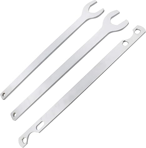

This set includes two wrenches (also a 32mm for other cars), and a holder that slips over the bolts holding the pulley to the water pump flange. It's shown in the first Amazon link I posted above.
