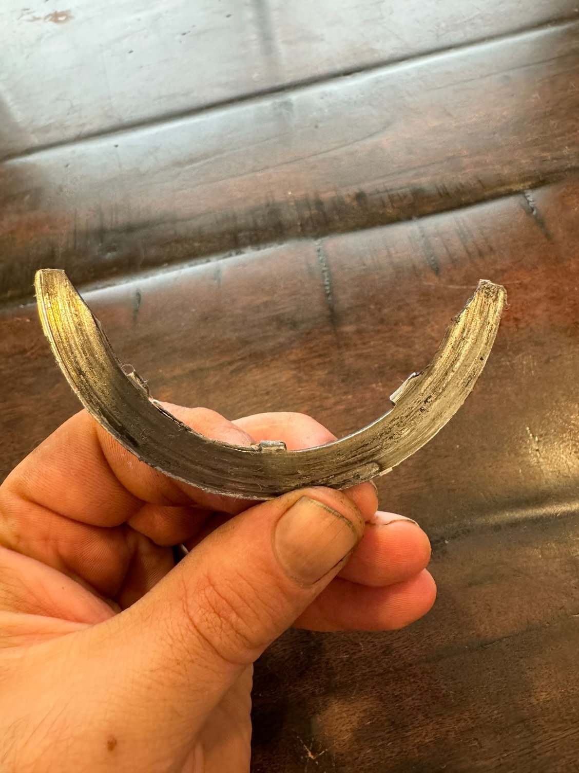

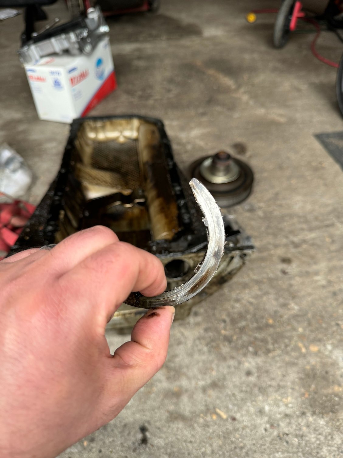

I have a 2003 land rover disco 2 that has developed an oil leak in several places. I thought it was the oil pump or front seal, but when I dropped the pan I found a large flat metal ring (or what looked to be a ring) with small notches on the inside. Does anyone know what this is?

Picture was with original post. Not sure why you can't see it.

Looks like a broken washer or spacer of some sort. Maybe a camshaft float spacer? (Not sure if these engines have such a thing.)

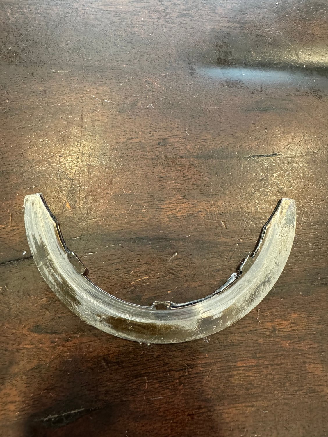

Default Not a broken ring, but a whole piece
So I washed the piece and it appears to be whole. Exactly a semicircle with three tabs

It’s also magnetic if that helps.

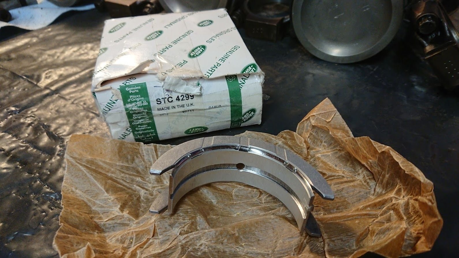

Measure the diameter and thickness. looks like the thrust bearing off the crank.
Old May 6, 2024 | 07:33 PM
AndrewDF's Avatar
7th Gear
Joined: May 2024
Posts: 7
Diameter is 3.5 inches and the thickness is 1/16 inch.
Old May 6, 2024 | 08:25 PM
Extinct's Avatar
Posts: 5,341
Likes: 1,837
From: Lynchburg VA
Yep, that is your crankshaft thrust bearing. Gonna need to replace that.
