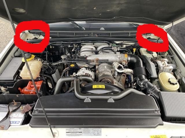

What are these connected to?
Old Oct 31, 2022 | 07:26 AM
PilotHobs's Avatar
Joined: Oct 2022
Posts: 66
Likes: 26
From: North Carolina
Default What are these connected to?
Mine is just a plug and not connected on either side.
TIA
Hobs

Those are the plugs for the heated windscreen.

Can you help me correct it. I need a diagram and how it works.
THanks

If theres no cables coming from the windscreen to the plugs, and You can't see tiny wires going from top to bottom within the glass, almost edge to edge, You do not have a heated screen and that's it.

So someone replaced the windscreen and didn't buy a heated one? Or can you add that to any windscreen.\

Glass has to have the heating wires embedded in it.

Yeah, if there ever was one installed originally.
Do You have the switch on the dash?
https://www.roversnorth.com/parts/yu...n_discovery_ii
Are the R8 relay and F7 and F8 40 amp fuses in the engine compartment fusebox?

I do have the switch and fuses. Thanks for he diagram

Yep,. someone just cheaped out on the screen when they had it replaced.
Had the same on mine by some previous owner, but I had a heated one put in this summer.
